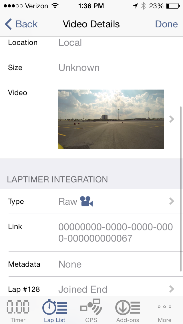

This is how the gopro video looks in terms of lap time integration. I did a manual link to it, not metadata. is that the issue?

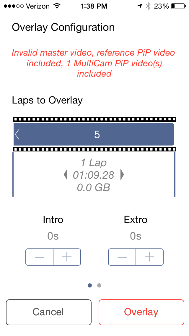

This is the warning seen in the overlay screen

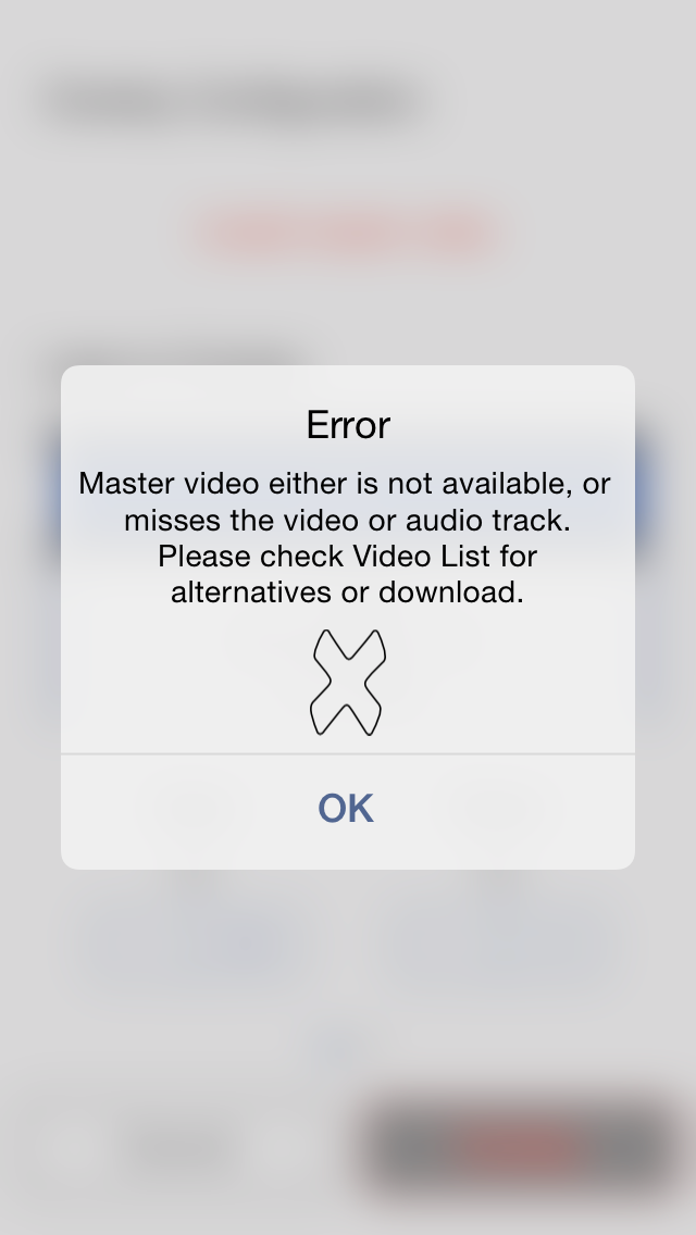

This is the error message seen when hitting the overlay button

Does the video have an audio track? Actually it is strange you do not get a duration in video details and get invalid states not only for the master, but for the reference and PiP too... Have you tested if it is possible to play the video?
