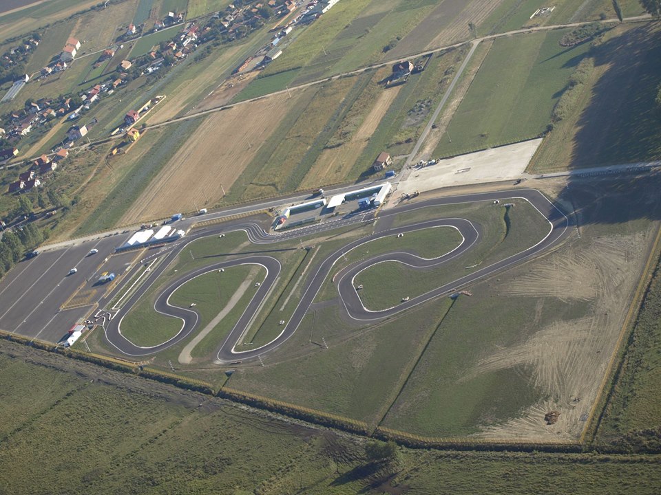

hello
Do you think harry`s lap timer rookie version works well on a circuit like this, karting circuit is small.
I want rookie versions for the moment because I saw you do not have the logistics for that version petroland,i have sony hdras30v actioncam
Do you think I can buy with confidence and use in this circuit?
i have iphone 4s ,i use for motorcycle
tnx !
skat kart Tg. Secuiesc Romania
Re: SKAT KART TRACK - Tg Secuiesc Romania (small track)
Yes, there are several kart tracks defined and used already. For the start/finish you set using the built in assistant, take care you add a driving direction to. This is important for tight tracks and work around false alarms on counter straights.

Use the New Track assistant first. Once you are done, select Lap List, search for your new Track and find the User Track Set row. Press it and select the Stop/Go trigger defined by the assistant. Press it and add a direction (0 is North, 90 is East and so on). That's all.
