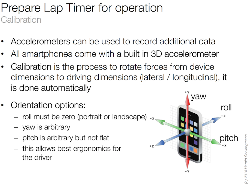

Harry, if one is using external GPS and video, then am I correct that the only restriction is that the screen should not face vertical (i.e. the phone should not lay flat)?
Re: USing a gopro - where to put iphone?
Yes, here is the full story...
