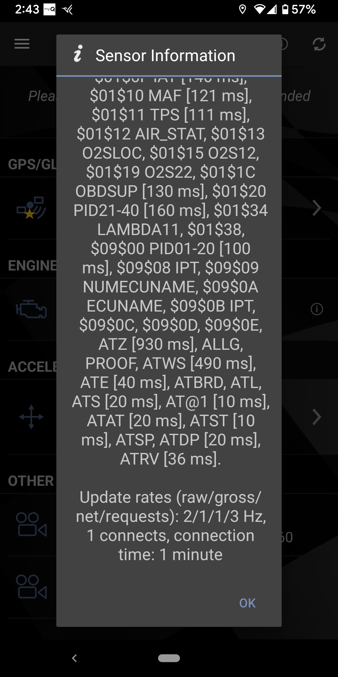

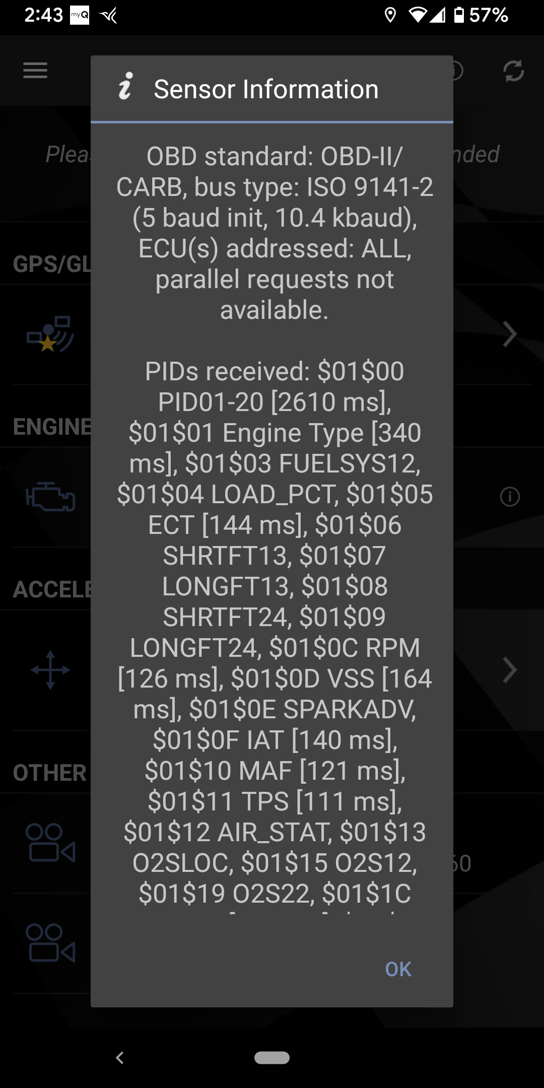

Here you go...
Posts: 10646
Re: OBDLink LX not connecting?
ECT (coolant temperature) is available and is delivered. EOT (oil temperature) is not available for your vehicle.
The other observation: your car uses a pre-CAN bus protocol. These are quite slow. Please expect 1 or 2 Hz update rates only plus some slow updates in the interface too. Oddly, there is little one can do with these old protocols (except changing the car :-) ).

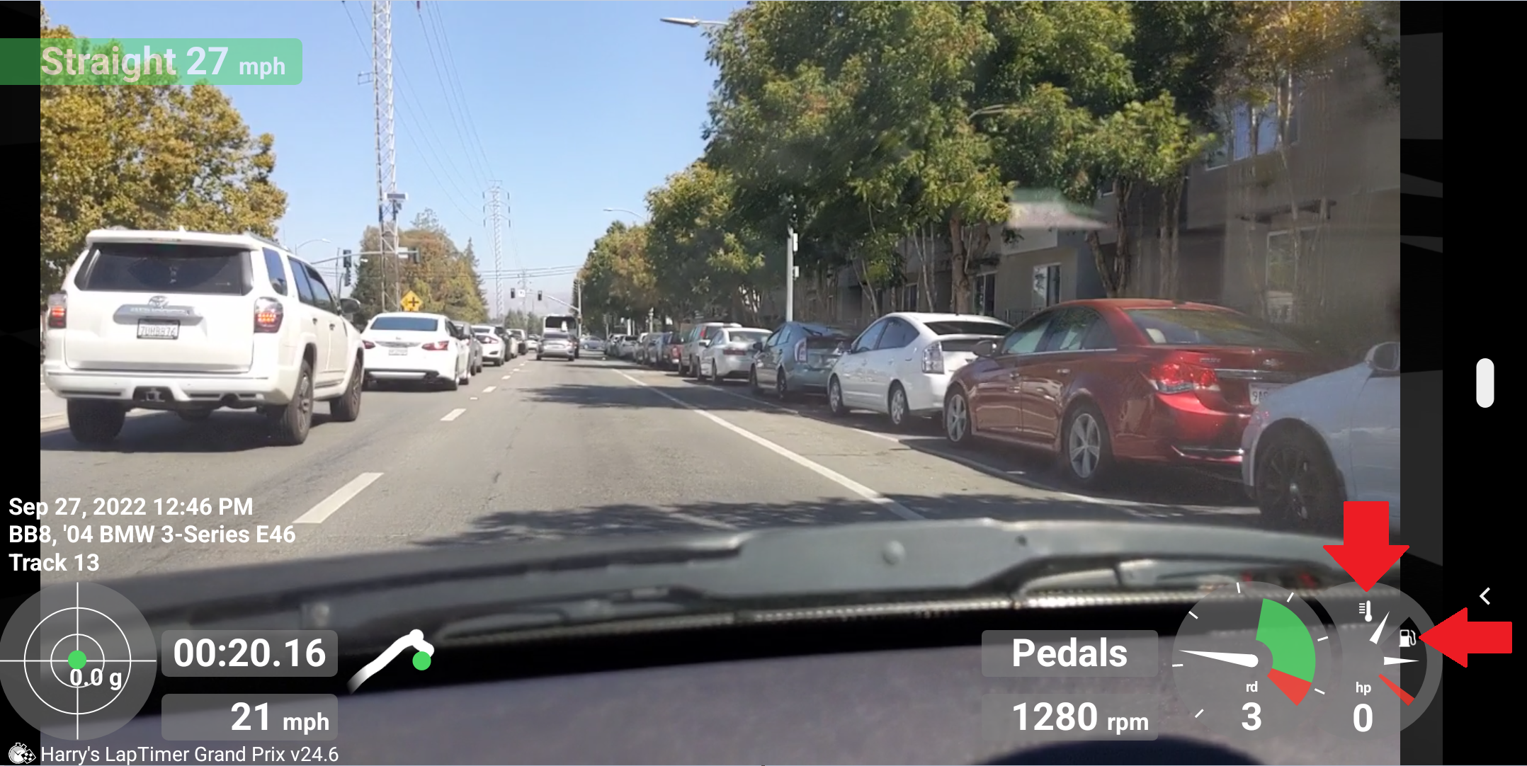

Here is something odd, in real time I don't see the Thermometer & Gas pump icon BUT when viewing the recorded video they do appear.
