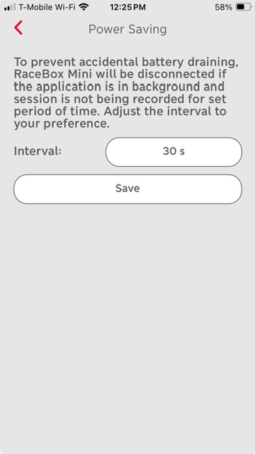

Lastly, just for avoidance of doubt do you think this setting in the Racebox app is what might be causing the device to temporarily shut off? I don’t actually have the app running at all but I wonder if this setting reflects the the device’s behavior?
Screenshot 2024-07-03 at 12.25.11 PM.jpeg (31.87 KiB) Viewed 55161 times
