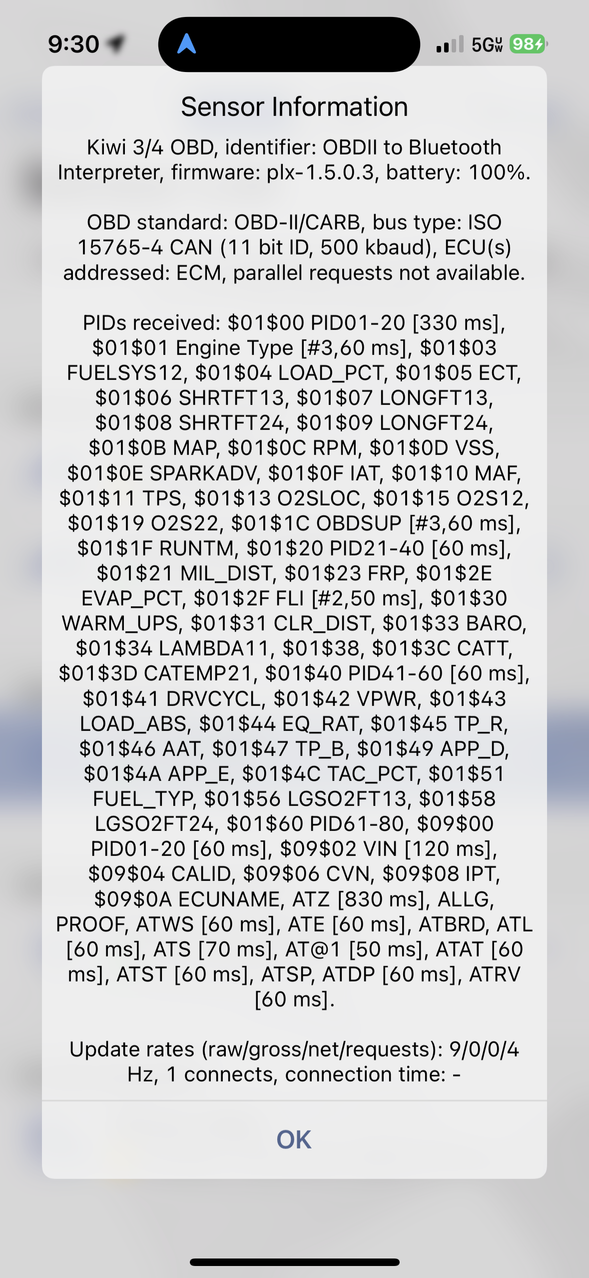

I am running v24.8.2.186 Grand Prix Edition on iOS. I’ve used Kiwi 3 successfully many years ago but I’ve had difficulties in recent weeks on 2 different cars. First was ‘06 BMW Z4 M coupe and the other is a ‘15 BMW F10 550i. Sensor list shows successful connection but whenever I am about to race, the OBD refresh rate shows as RED: “The OBD sensor does not receive data at an expected rate. Please check compatibility between…”

The snapshot is showing there is communication (including specific PIDs), but obviously communication is not stable and incomplete.
