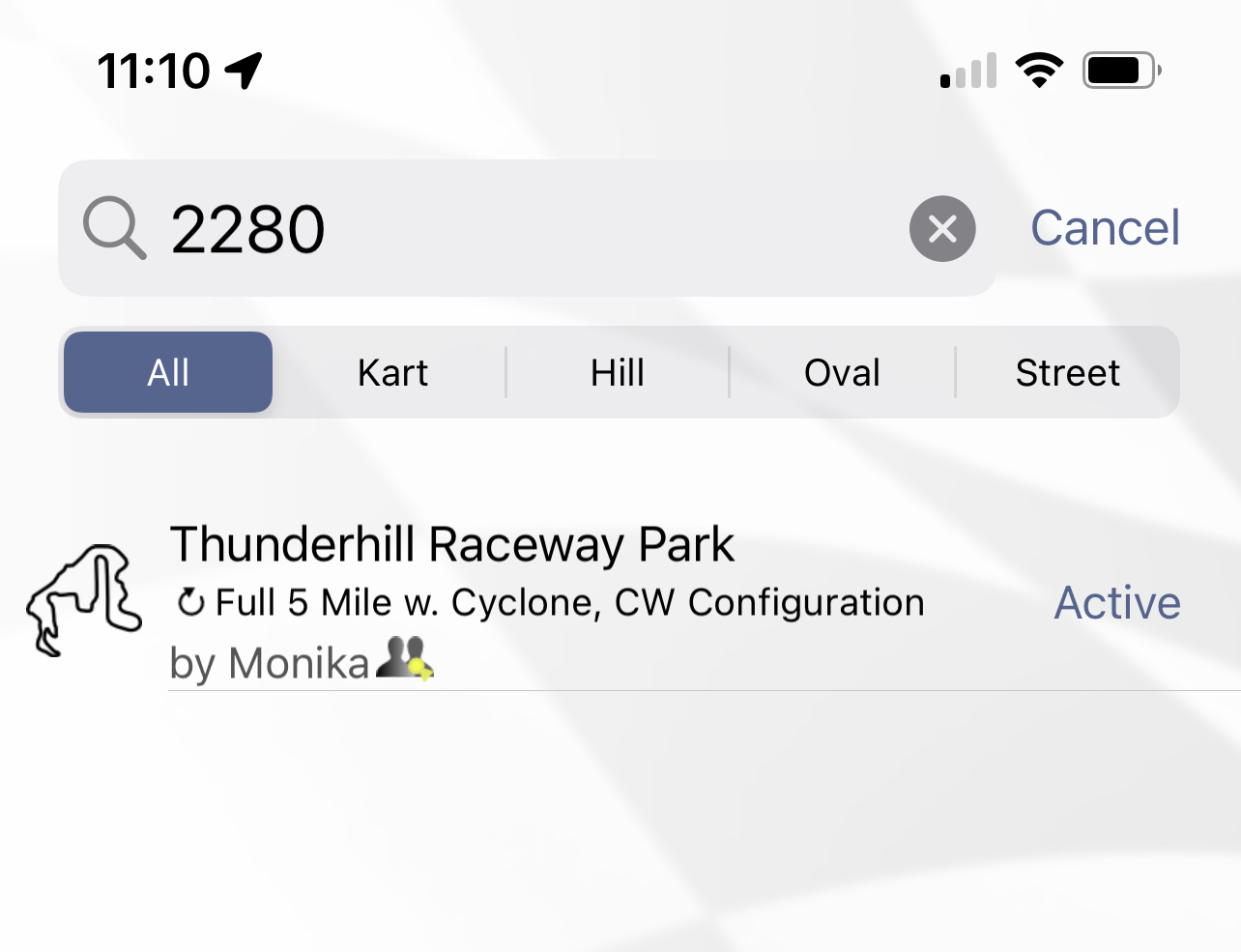

there is a new 5mi clockwise configuration now available for download!
In the app -> Admin -> Add-ons,
update list with button top right.
Afterwards search for Thunderhill or just with the ID of the new configuration: 2280 and it will be listed for download.
- 0FE99698-8DE2-4A82-9C98-9D540F8D869C.jpeg (204.38 KiB) Viewed 35904 times
Re: Thunderhill 5 mile CW direction
Thank you!
