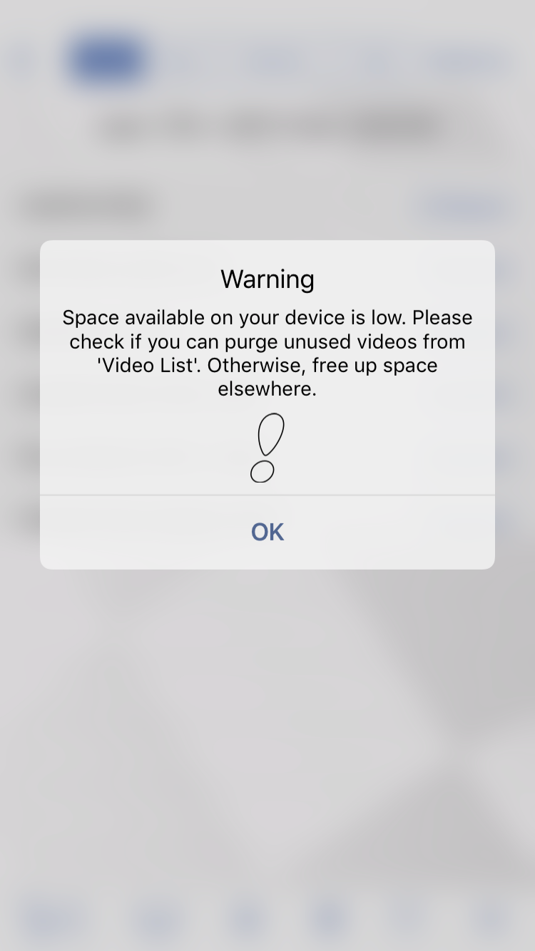

I am getting a low space message in Latpimer v24.7.1 and cannot record any sessions and videos. See error message below.
The lap timer recordings list is empty. All the videos are in Multicam iCloud or Photos App. iPhone storage shows 42GB available. My iCloud shows 39GB available. How can I resolve this problem?
I have an iPhone 6 with 64GB of storage running iOS 12.5.6. I have been using Laptimer on this phone for a number of years and the database is 74MB with 574 laps.

I assume you get this warning shortly after starting LapTimer? Please confirm.
This is a warning only. It should not have any consequence on LapTimer operation.
Do you get any error message later or what inhibits you from recording laps or video?

Yes. The warning comes when starting laptimer and does repeat more than once. When I check administration/system is shows available memory: 0GB. I have also tried to test it by setting up autocross outdoors while walking. Checking System Status shows storage < 0MB. When I cross the start line the timer does not start.

The problem is around iOS's memory management. It uses all free storage for caching. Once apps request more space, the caches are freed up. So technically, there is no memory available, but once an app requests more space, it is receiving it. Later iOS versions allow to check for free plus cache-used memory, your does not. But again, these are warnings only. So in case your AX doesn't work, there might be a different reason! As an example, LapTimer will not trigger when walking. That's too slow.
