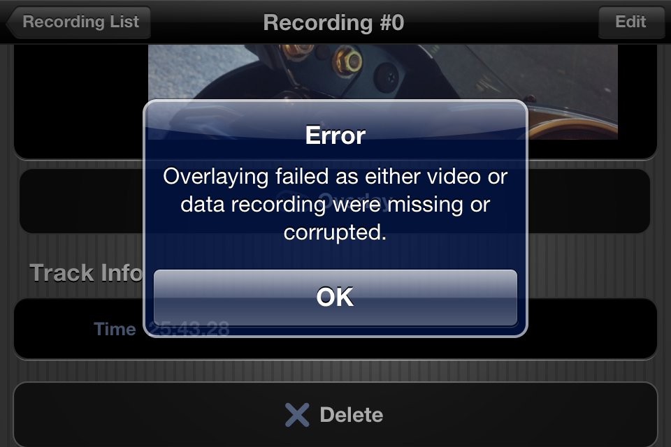

Thanks Harry,
Any thoughts on this. I was using a Dual XGPS150 and the signal icon was all green bars with the GPS before i began the journey.
Attached is a picture of the message that comes up when i try to do the overlay.
The recording list only shows 2 GPS fixes.

Problem with the GPS connection I guess. There is no other reason I could think of. Sometimes the connection between an external GPS and your iPhone is established but actually not working. Restarting the app / the GPS mouse usually helps. You can check if you connection is really delivering GPS fixes looking into the status bar in Video View. The red / yellow / green bar shows the quality of the LAST FIX RECEIVED. This fix however, can date back some time... So in addition, every time a fix is coming in, the small satellite's beam blinks. So to check you connection, make sure it blinks AND the bar is green.
Hope that helps, Harry
