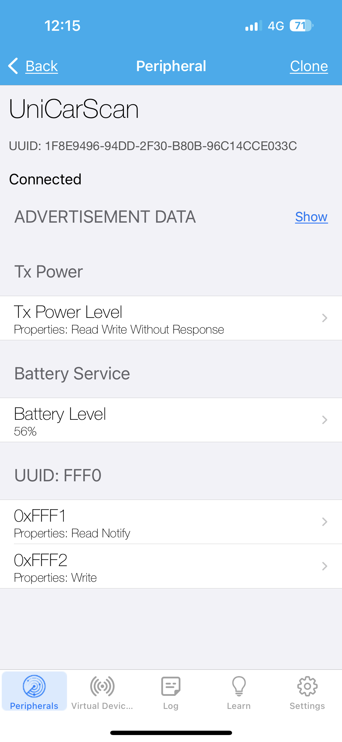

Hi Harry
I thought I’d made a post about them same issue last week, but it’s vanished?
I have the same unit and uses Bluelight to scan for the UUIDs, but I can’t work out what the send and receive UUIDs are using this method. Screen shot attached.
Can you assist?

Characteristic for send UUID is FFF2, receive UUID is FFF1.
