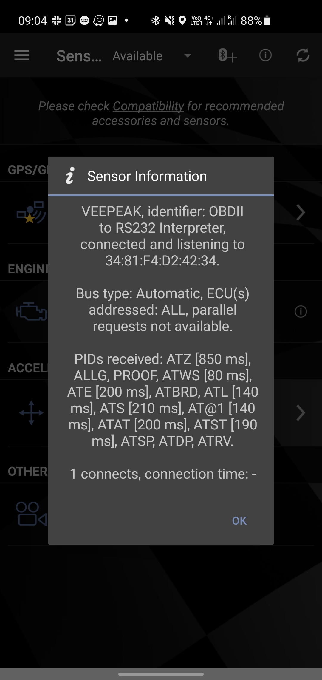

This is what shows on the Sensor Information modal no matter what I change in expert settings.
Re: Refresh rate problem with VeePeak
The adapter is not negotiating the bus protocol successfully. What you see in Sensor Information are just the commands exchanged between app and adapter - during setup. Please try selecting the proper Default Protocol in LapTimer / Administration / Settings / Expert Settings / OBD Tweaks. This may help the adapter to select the correct protocol. Most modern cars come with a CAN protocol. 11/500 mostly. Please Refresh Sensor List once you have changed the protocol. This is required to activate the changed settings.

Selecting CAN 11/500 did the trick, it works now! Thanks!
