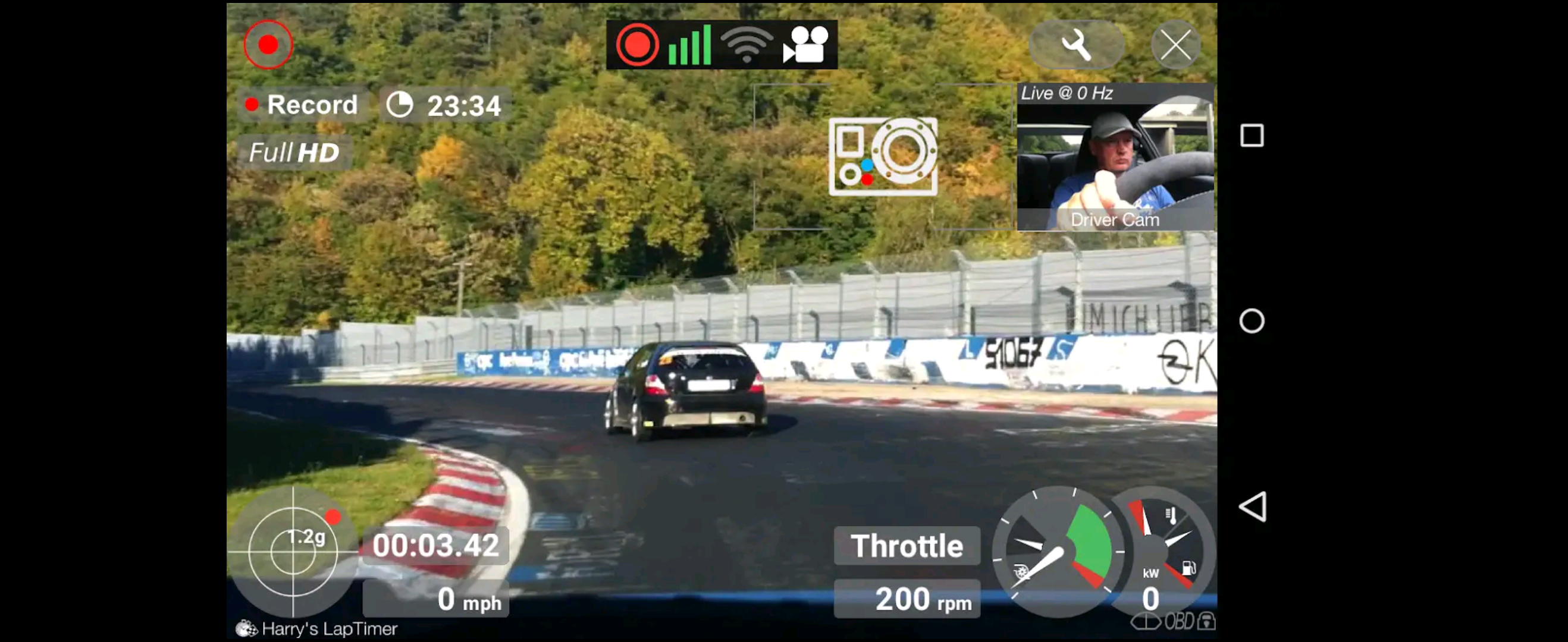

In the Google Play Store the screenshots of the Timer recordings show a number of elements overlayed on the video. In addition to the g-meter, timer and speed in the bottom left corner, there are graphics for throttle, RPM, and another graphics in the lower right corner. How can this view be customized?

Actually it is not about customizing, but simply a question whether engine data is available. Once you connect one of the OBD sensors listed on http://www.gps-laptimer.de/compatibility/ios or http://www.gps-laptimer.de/compatibility/android, LapTimer will record this data and add the gauges. GrandPrix has the second gauge showing temperature, fuel, power in addition. Petrolhead will show the left gauge only.
