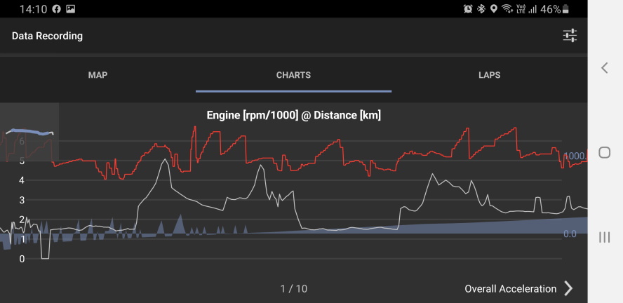

Few years ago (approx 4), when I bought OBDLink I had refresh rate about 8Hz and faster, but in last 1-2 years I see rapid fall in refresh rate in HLT (I´m happy if I get over 6Hz). Maybe it depends on firmware on OBD? I can try some older firmwares. Or exclude all unnecessary PIDs?
On track, i had timer view, so I did not check rates on OBD :/ But yes, data are realy "stepped", you can see it in the picture (also on video it´s really annoying)
I tried DashWare and RaceRender and I saw RaceRender have a feature to artifically smooth data. Do you planning something similar in the app?

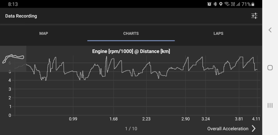

So I tried it only with internal GPS, and result is the same like before. You can see it in the picture. I checked expert settings. Before I had one custom PID defined (fuel), so I disabled it, without success. Also I make a short screen recording on engine page. Rate flows between 1 to 15Hz.
I double checked everything (I hope so). Also I tried several firmwares. I also disconnected smartwatch, so to the phone only OBD was connected via BT nothing else.
It´s possible there is a problem with data flow from the car?

Yes, this is too much... Please create a log as described in the Debugging OBD FAQ here in the forum.
