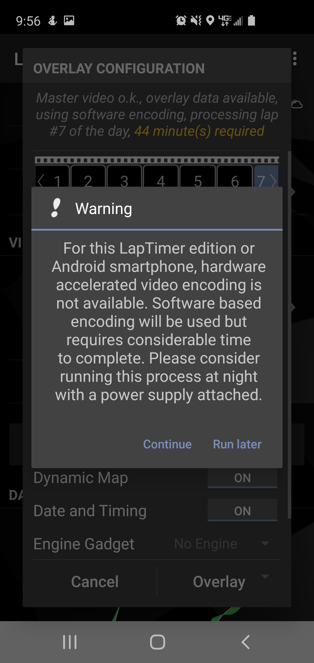

I can overlay a video, despite it taking forever. When its finished, no preview is available, but sound is there. The video isnt in my gallery

When using hardware encoding on Android devices, LapTimer needs to map frames completed to the smartphone's internal graphics memory planes. In case the manufacturer uses some common plane structure, hardware encoded overlays will mostly work. Once a manufacturer introduces specialities (Samsung is doing this all the time), frame data will be written to the wrong memory areas. This can result in crashes, or empty screens, or something in between. So in case it doesn't work directly, forget it and stick with software encoding. The S10 is powerful enough to accomplish software based overlays within reasonable time.

Thanks. how can i switch to software only then? I only want to export a few laos for me snd a few friebss purposes.

Administration ‣ Settings ‣ Expert Settings ‣ Video Tweaks ‣ Use Hardware Encoding ‣ remove tick.
The overlaying time estimate will be far too high for a S10. It will be around double the lap time.

That makes the overlay eay faster, but the file is still "lost" somewhere in the phone. Its only a 1 lap overlay and i had to fix it by screencapturing straight out of Harrys
