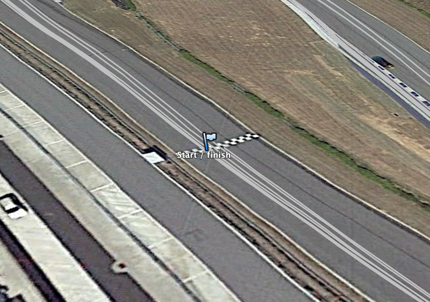

On AMP: according to the data you have sent in parallel, the S/F line for AMP is positioned perfectly. We will check driving direction as the second important parameter for trigger detection.

We have found the problem with AMP... The problem is about the third split shortly ahead of s/f. Whenever LapTimer hits a tigger (like split or s/f), it pauses detection for 2 or 3 seconds. So the faster you driver, the higher the probability s/f will be missed because LapTimer is paused from split 3. The quick work around is to remove the Split 3 from the track set (Lap List ‣ ATLANTA MP ‣ Certified Track Set ‣ Split 3 ‣ Delete.
