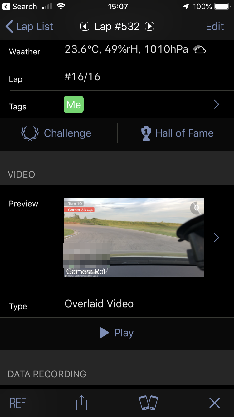

In the lap details, I can see a thumbnail of the video which is marked "Camera Roll", under the thumbnail it says "Type : Overlaid Video" and below there is a PLAY button.
If I press PLAY, I can see the overlaid video properly. There is no Revert button,

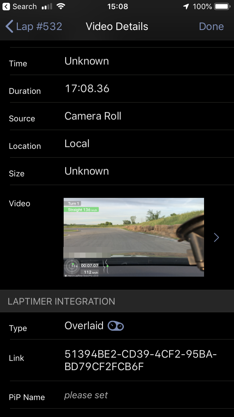

If I press the thumbnail in the Lap Details page, I can see "Video DEtails" where it has unknown date, unknown time, Source camera roll, location local, size unknown.

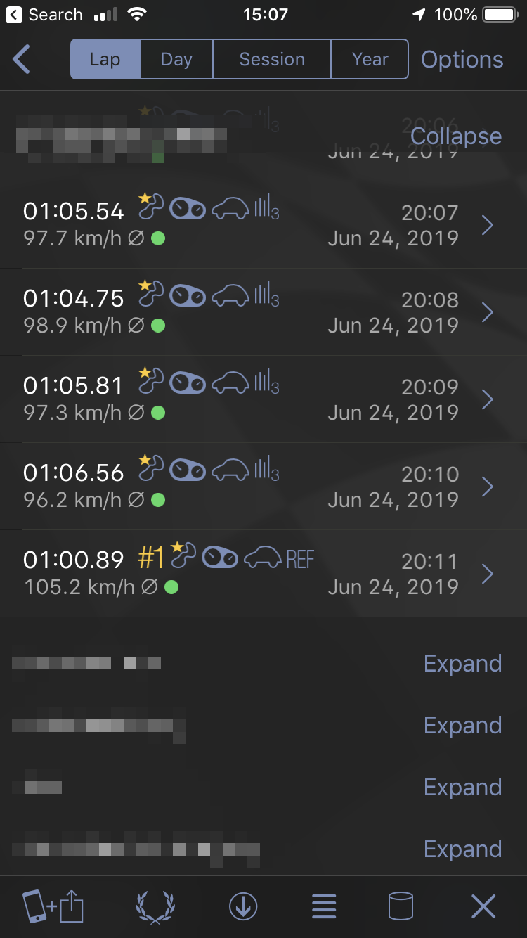

Laps list:
Lap details:
Video details:
Re: Export Video a 2nd time
Posted: Wed Jun 26, 2019 8:26 pm
It looks like the overlaid video has not been deleted. Otherwise, it would not be possible to see a thumbnail or watch it. The original session video (without overlay) however seems to have been deleted. Otherwise you would get the Revert button to switch back from the overlaid video to the original one. You can double check by browsing through video list. In case you find the original video here, we can link it to lap again for another overlay.
