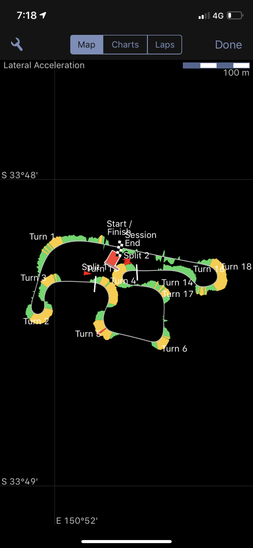

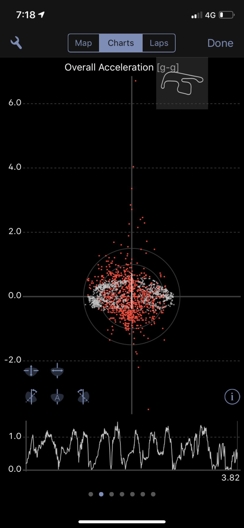

I’ve been using the app for almost two years (love it) but recently I realized the lateral acceleration recorded is crazy, very erratic showing lateral acceleration of over 3g, any idea what may be the problem?
Thanks .... love the app btw :)
Below screenshots of how the graphs look

Lateral acceleration for motorbikes is actually calculated from downforce. This is necessary because lateral acceleration measurements will deliver around zero due to the lean. The disadvantage from this calculation is that it is very sensible to wrong mounting angles. See illustration #4 in Quick Reference. So the answer is “please check angles of your mount”.
In case this doesn’t work, please use. Calculation from GPS measurements: Lap List ‣ your lap ‣ Positions ‣ Recalculate Icon ‣ Acceleration.

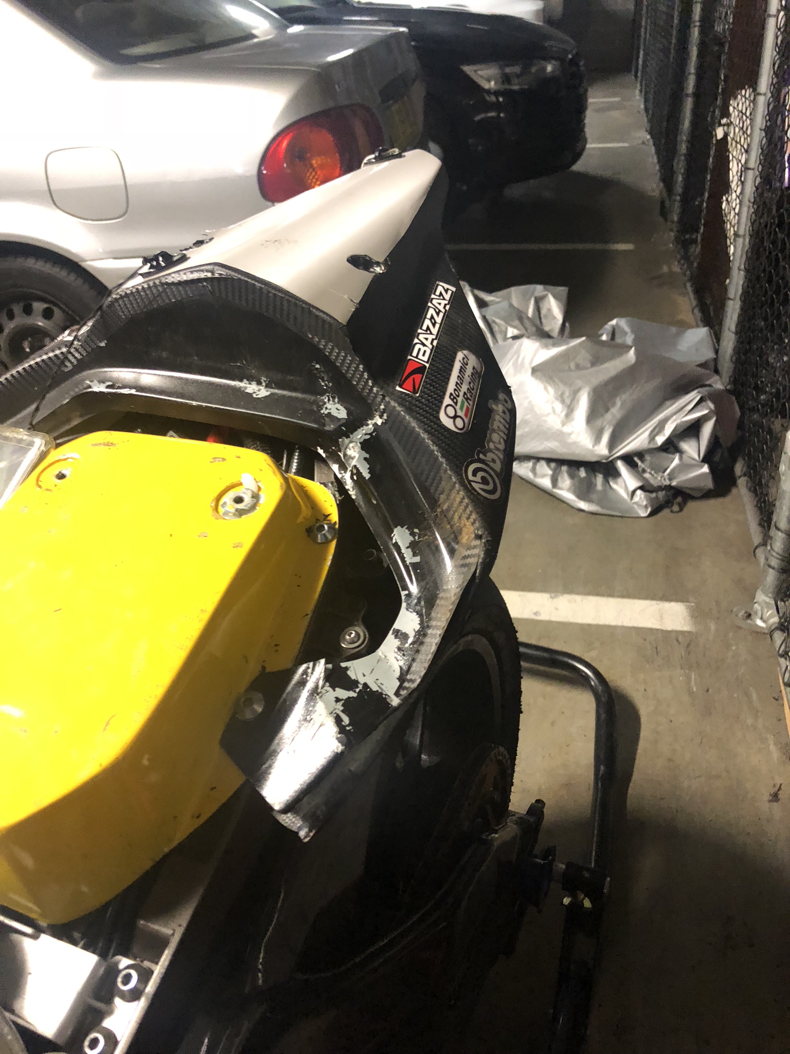

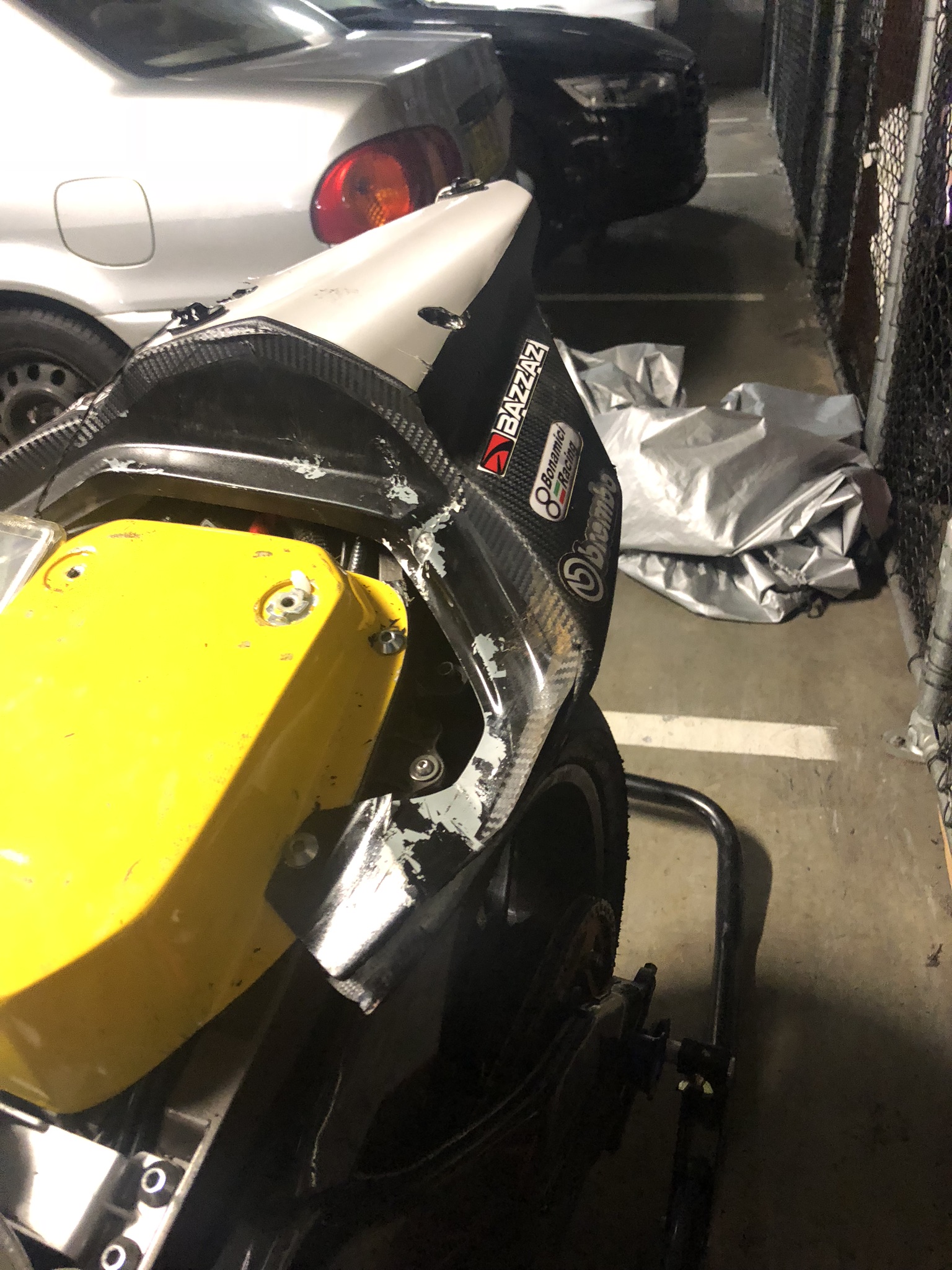

My phone is currently mounted horizontally in the back of my sit with the screen facing me, you can see it on the below photos so you can get an idea.
Re: Lateral Acceleration Not Corrrect
Posted: Wed May 29, 2019 6:43 am
This looks like it is correctly mounted for driving backwards? :-) If not, try to adjust it like this. Goto Expert Settings and select flipping both longitudinal and lateral acceleration. This may work.
In case this doesn’t work, use calculated acceleration please. Select any lap from your session from Lap List. Select Positions / recalculate icon in the bottom / Acceleration and use the slider to get a realistic result. Confirm this calculation is applied to the whole session when asked.

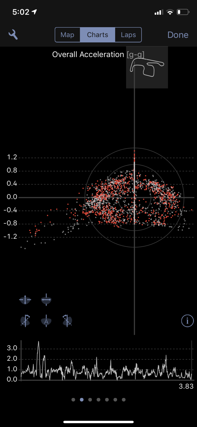

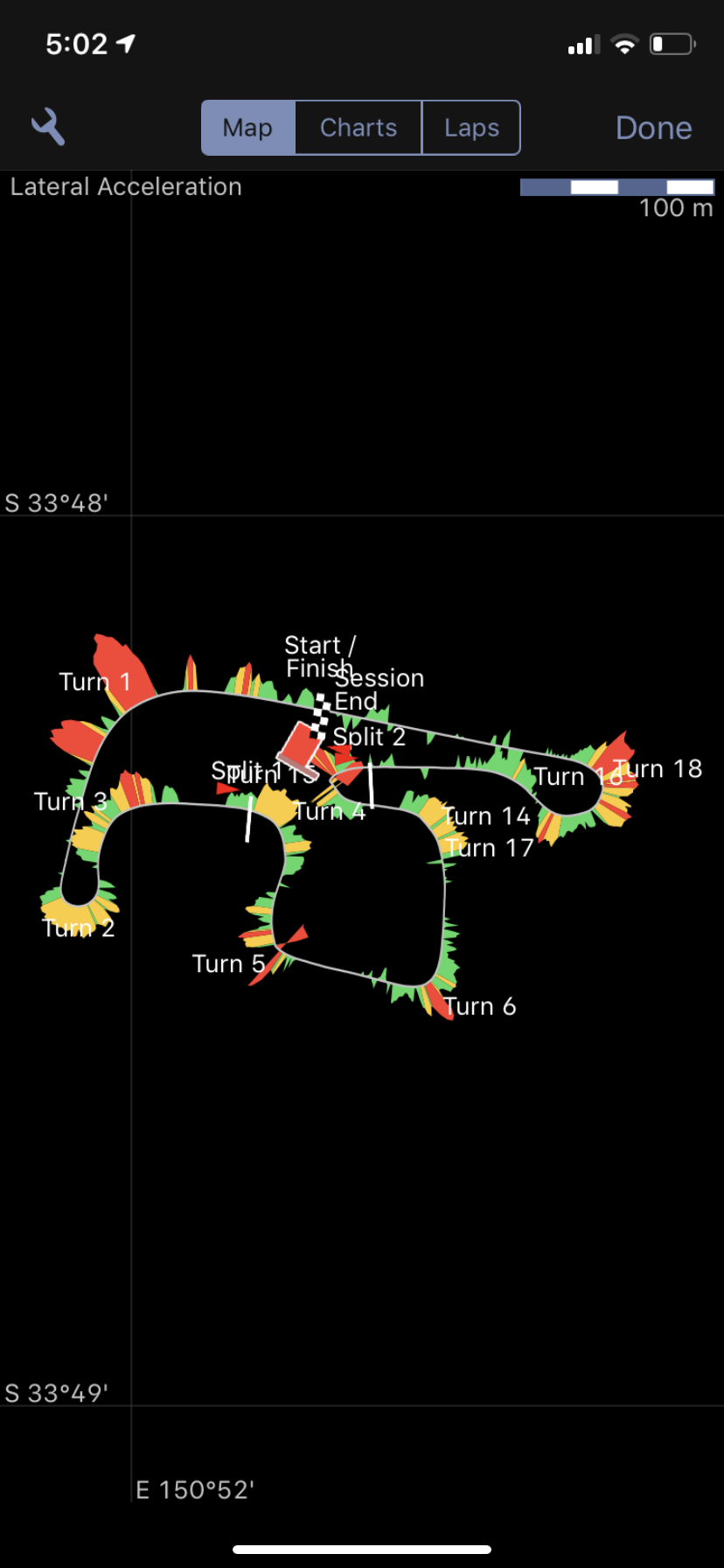

The red dots are my new reference lap taken last week (all erratic) while the white dots are almost 1 year ago.
Thanks!!

When recording a video, a different orientation is used. This means a different rotation matrix is applied. See www.gps-laptimer.de/documentation for the document "Acceleration Handling".
