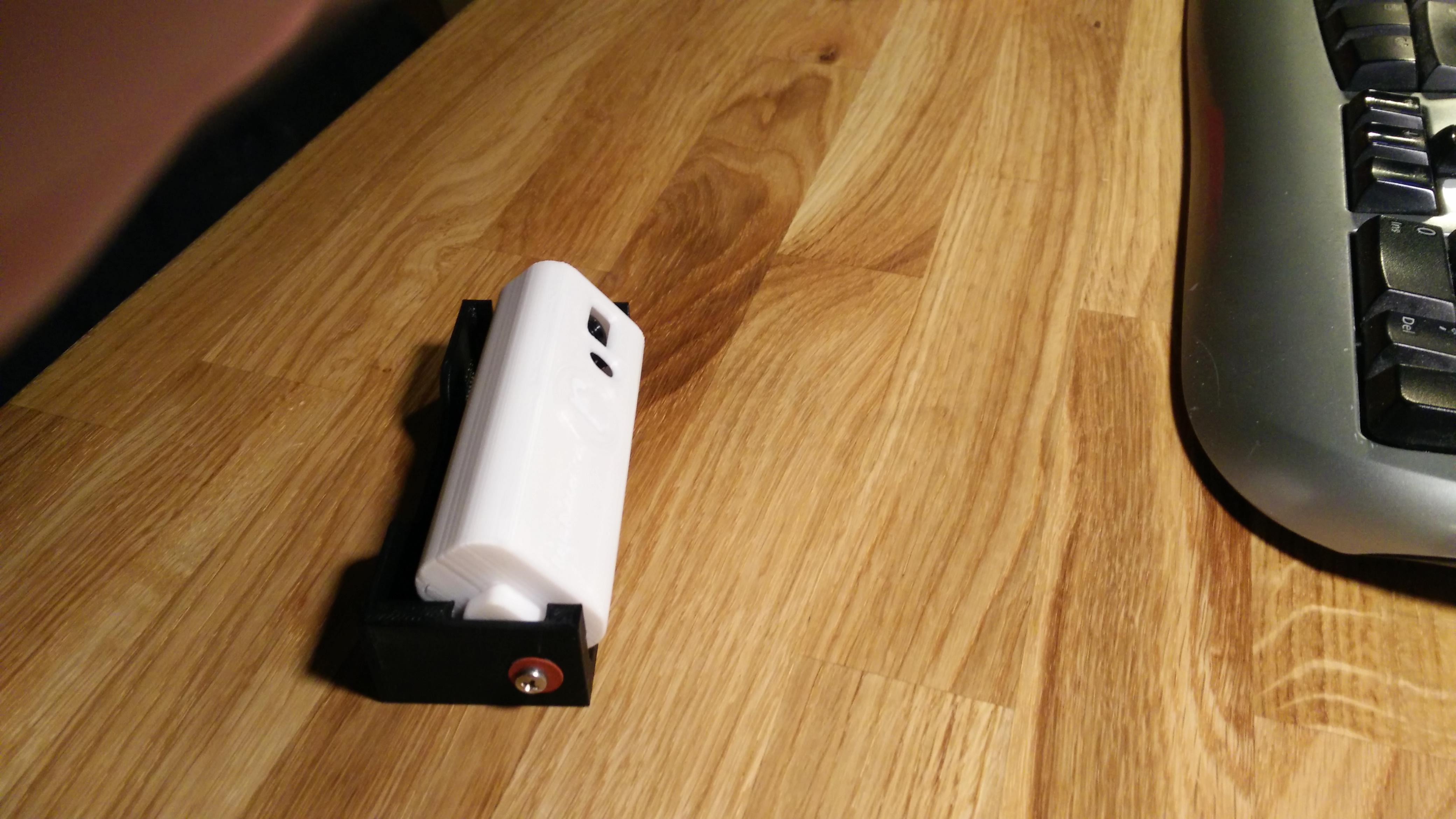

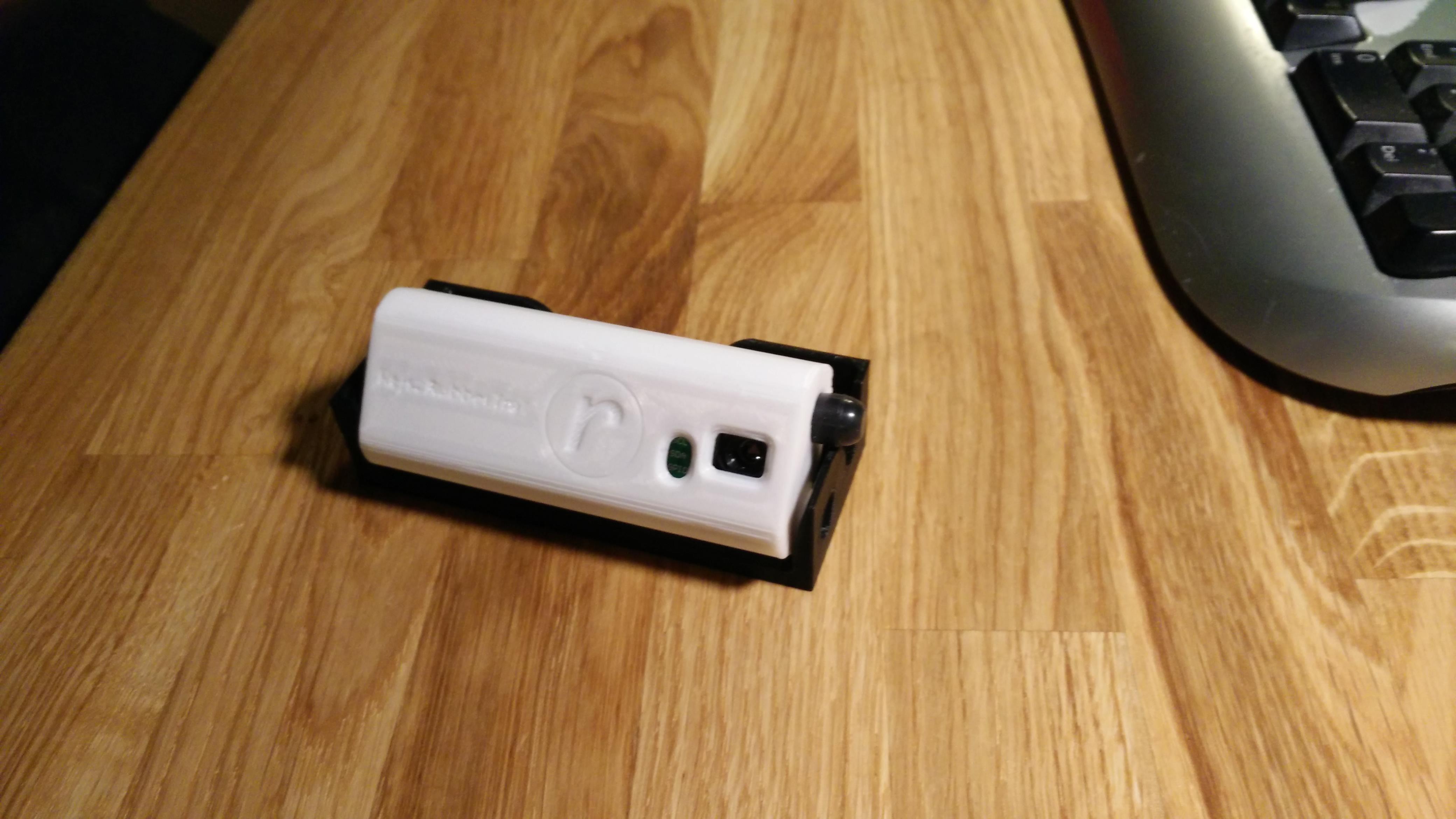

Early test 3D prints of housings
main housing early wip 2.jpg (667.95 KiB) Viewed 84437 times
main housing early wip 1.jpg (540.95 KiB) Viewed 84437 times
