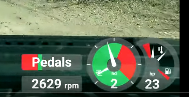

Hello, I finally got to use the full OBD info on my track session two days ago, and it worked quite well. Something I haven't figured out, however, is why my entire gauge is filled with color, as below:

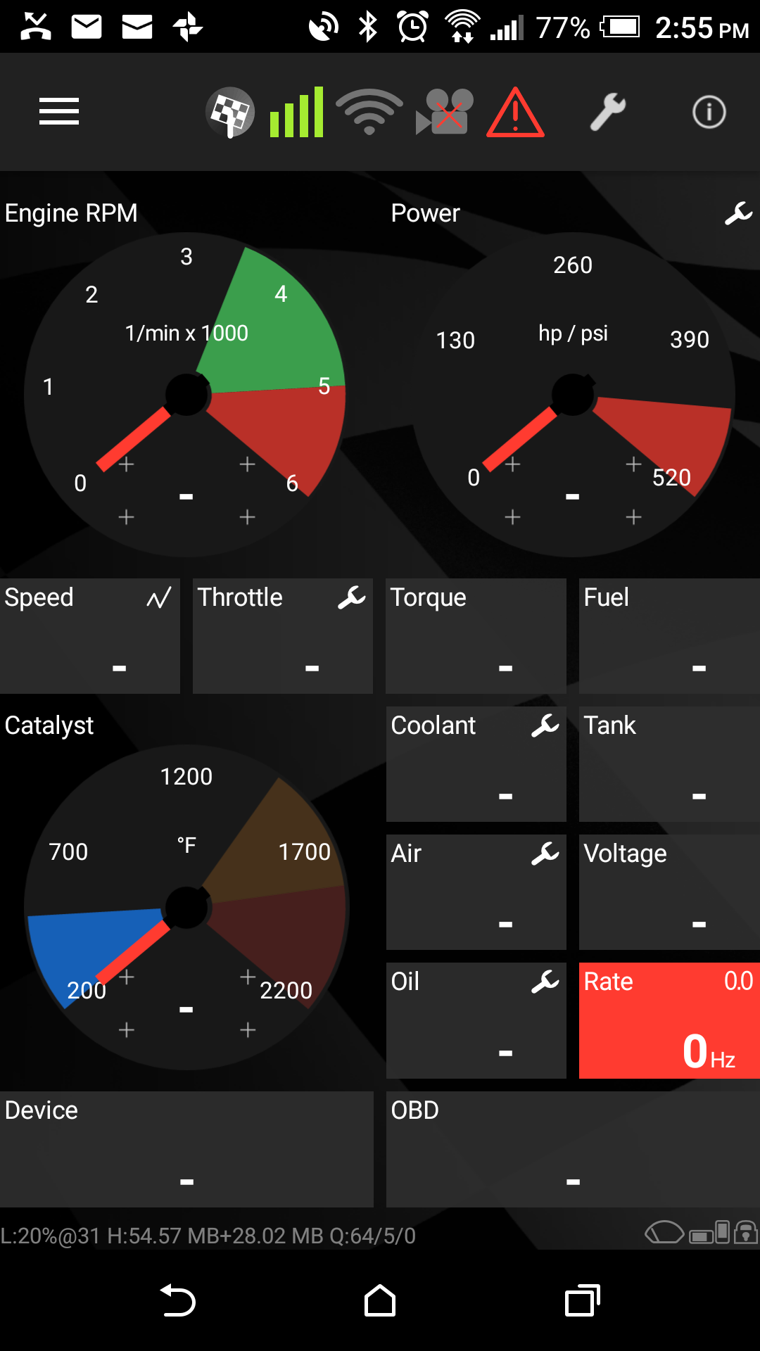

As far as I can tell my vehicle's data is correct in the app. The 'Engine RPM' gauge under the "Engine" tab on HLT looks good as well, being green shaded from 3.5k to 5k, and red onward. I would like to have the overlay one look like that for clarity, but I've not figured out how to do so. Does anyone know why this might be?

The green and red sectors are set from you vehicle definition's rpm parameters:
Max Torque @ RPM
Max Power @ RPM
Max RPM
So please make sure you have set all three rows in the Vehicle Details view in section Engine.

All three are set, verified from several different sources that they are correct. The shading here seems to correspond with the values (510 lb ft at 3500, 450 at 5000, and redline at 6000. However, in the actual overlay, it is as pictured above.

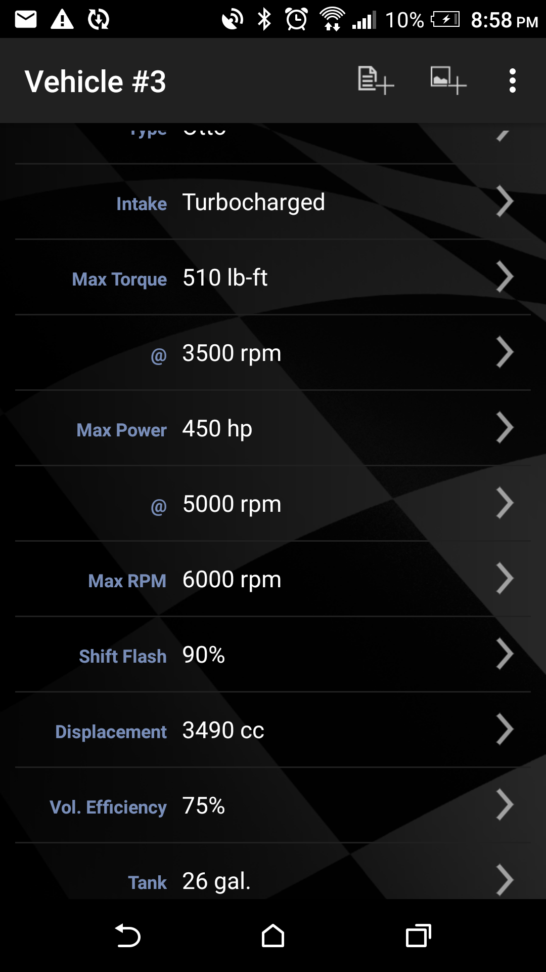

Please post a snapshot of your tank's details view - section Engine.
Re: OBD RPM Display gauge
Posted: Thu Jan 31, 2019 4:02 am
by T4nkcommander
Posted: Thu Jan 31, 2019 9:55 am
O.k., so this is looking good. Now we need to check why this data isn't used in the overlay. Please follow these steps:

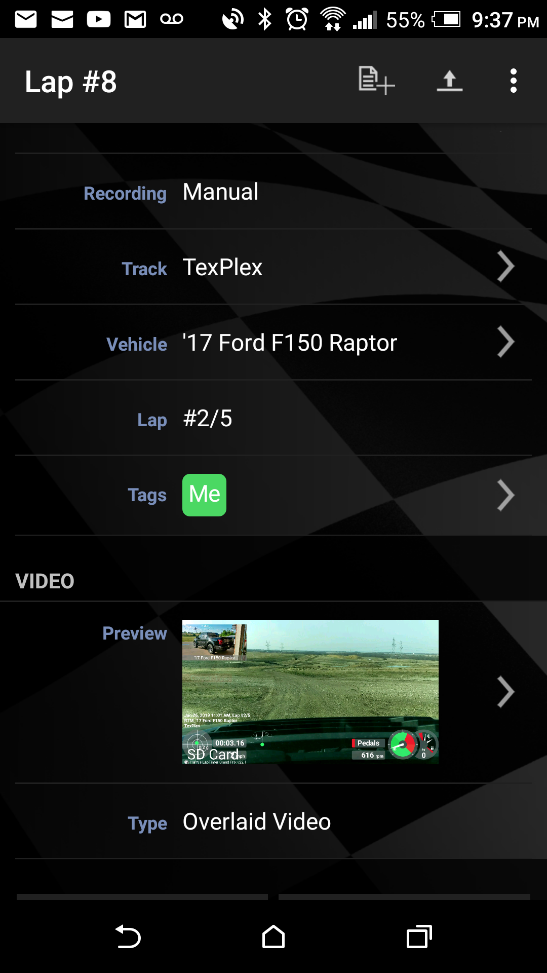

- select any lap with video recordings from Lap List
- in the Event section, make sure your Vehicle #3 is selected
- scroll down to Video Section
- in case the Type row displays Overlaid, press the Revert button
- you should see Play and Export now; select Export
- in Overlay Configuration, make sure you keep the one lap selection, start the Overlay
- check the result
