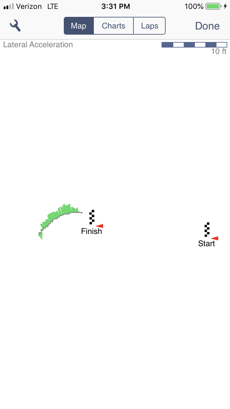

Everything was great until I updated the app in mid-August. Since then the app hasn’t been correctly trigging the start/finish at autocross. Two others, that I know of, are having identical issues coinciding with the app update.
I just spent this afternoon updating to ios 12.1 and trying every configuration possible with no luck. I’ve tested two competing apps and they both trigger perfectly. Can I back-date to the pre-August version?? I’ve now had several events with useless data.
iphone 8
ios 12.1
Grand Prix 22.1.2
xgps160 2.4.5
I’ve tried narrow/normal corridors, setting the compass direction, and nothing fixes the problem. Attached photo was one of my practice tests today. Timing didn’t trigger until well after the finish line poi!

Hi Harry, thanks for the reply. The screenshot above is with v22.1.2. It definitely isn't working fine for me. I had already run admin>check data prior to testing v22.1.2 last week. Initially it response with "Database checked, no problems discovered." Then after a delay on that screen, this pops up: "4-recovery database(s) found. Purging all but the 3 most recent will free up 2 MB of memory. Please do not purge old recovery databases in case you have no other backups created." After tapping "purge old", I run the check data again and the "no problems" and "purging" menus repeat. The purge doesn't appear to accomplish anything.
