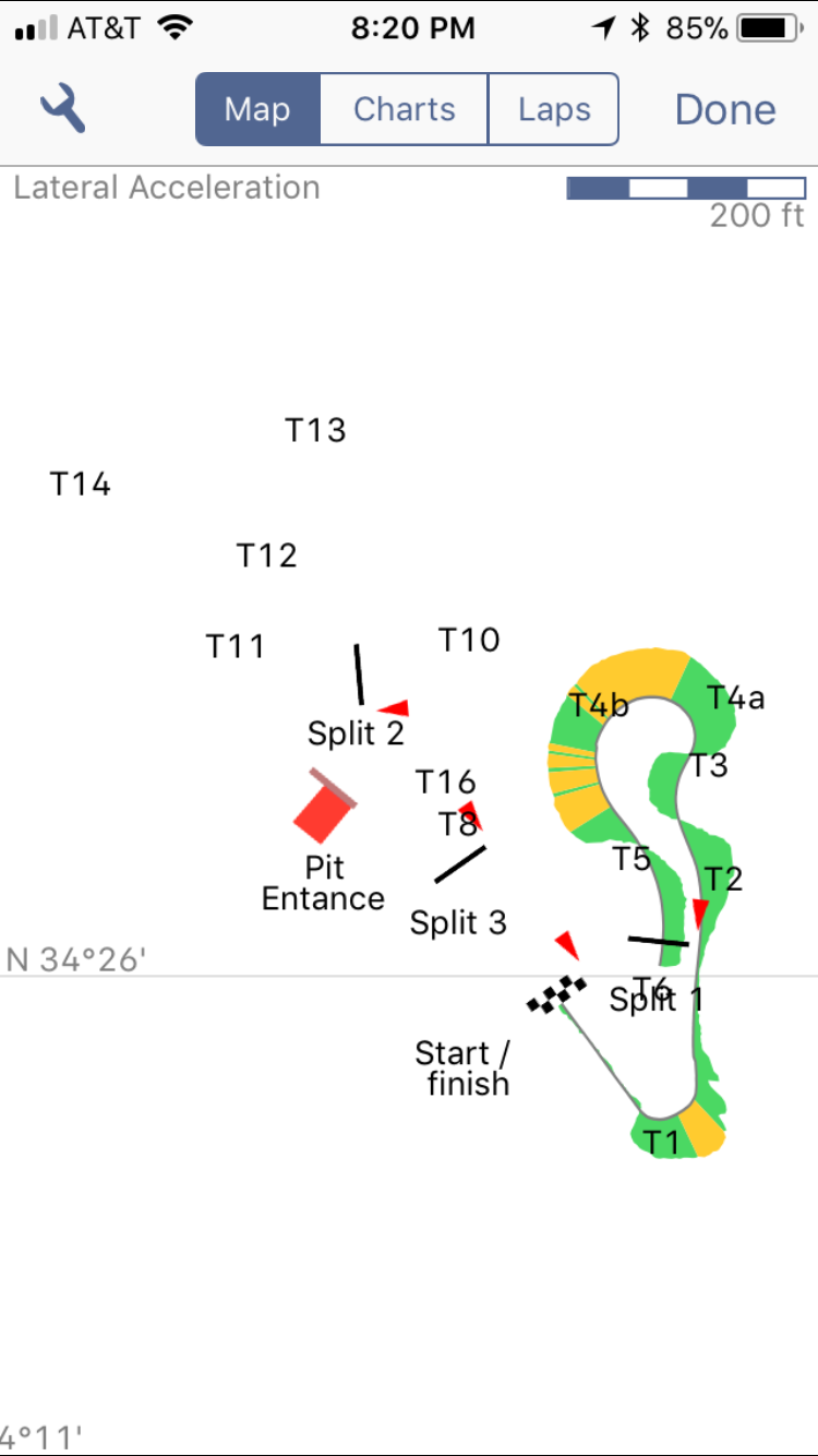

I was at Atlanta Motorsports Park this weekend and I didn't get a single lap recorded. I updated the POI's before going to the track, but they don't seem to be correct. My friend that didn't update his POI's seemed to get good lap times. The POI's I used last time I was at the track (March 2016) was just fine.
I was using my external Dual GPS (160).
Do you think this is a POI issue or something with my setup? Out of all the sessions I ran, only one didn't time out, but it never gave me lap time at the start/finish, so it has the whole session as 1 lap.
Here's a screenshot of the POI's vs. the data so you can see the mismatch.

we had an issue with a cancel trigger in the Atlanta MP track, some other users reported similar issues last weekend :-(
I corrected the track yesterday, please reload it - now it should work again!

Thanks Monika. Is there anyway to reprocess the data I captured at the track or is that session gone?
Thanks for fixing the track map though.

will be diffcult.... but please send me a small set of your laps to tracks@gps-laptimer.de and I will see.
