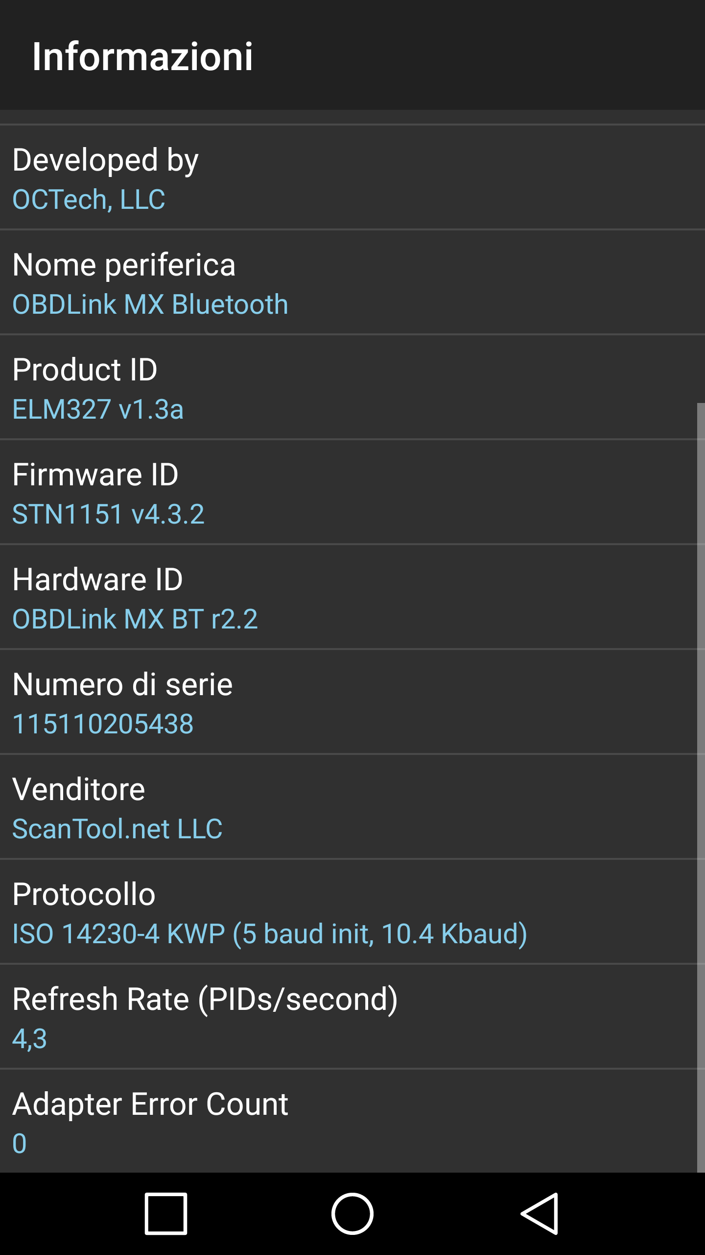

This is what I've got from their app.
Can be that slow? Is there anything I can do?
Re: OBDLink MX BT too slow
Yes, it is an ISO 14230-4 KWP - which is pre-CAN and pretty slow. LapTimer is optimized to pull data as fast as possible (it has 9 PIDs / s compared to 4.3 the OBDLink app pulls) and I do not have any levers to make it faster using an ELM accessory.
The only option you have is not reading wheel speed (LapTimer will replace it by GPS speed). This however will not make a big difference and you lose the more responsive OBD speed... Indo Not recommend this.
