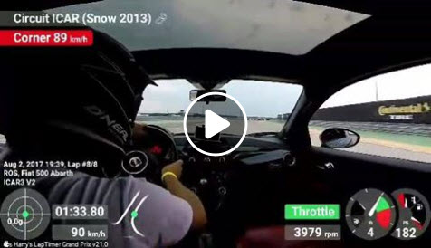

I just noticed some weird little bug. I created a video at circuit icar3 V2, and the OSD generated video displays the name correctly.
However, after using the export to facebook function, the name in bottom left position remains correct but the one in the top left corner has changed to a different track (icar snow 2013). See attached screenshot.
Re: Export to Facebook bug
You get POIs nearby shown in the top left while the name in the bottom left is the track's name (as used in LapTimer). In case you do not want the upper left information POI, you need to remove it from the track set. Some track sets come with a track name POI centered above the track. To remove goto Lap List ‣ ICARS V2 ‣ Certified Track Set and delete the "Circuit ICAR (Snow 2013)" POI.
