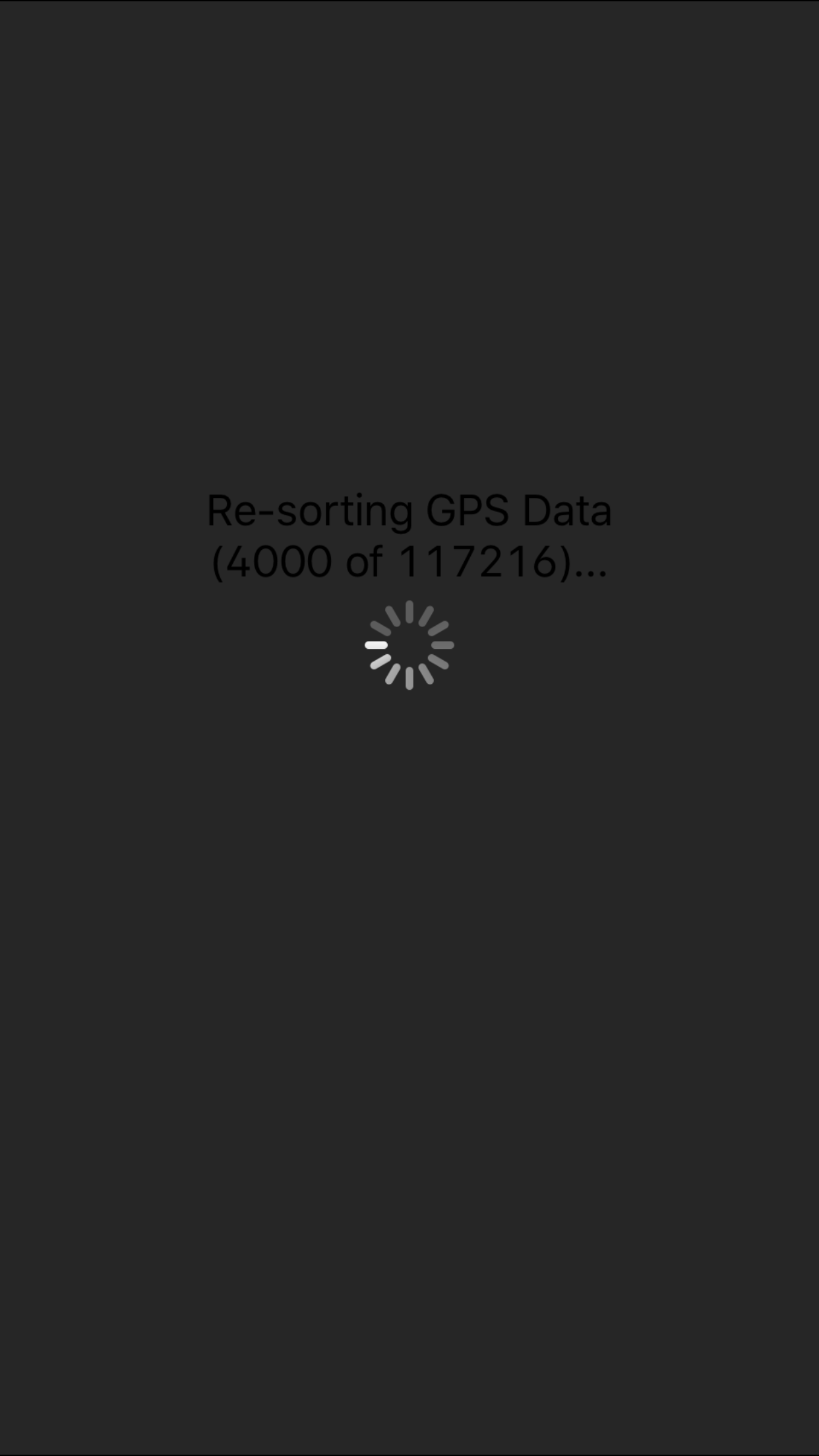

So then I close the app and try reopening but continues to update data and can't get back into main menu. I then reboot my iPhone and same problem!
This is the best screen shot I can grab before it goes black and crashes
Re-sorting GPS Data Keeps Crashing, Can No Longer Open App

- IMG_1929.PNG (97.05 KiB) Viewed 1691 times
Re: Re-sorting GPS Data Keeps Crashing, Can No Longer Open App
LapTimer fails restoring the data (i.e. crashes during repair).
To get LapTimer going again without deleting your data, please start Settings app and scroll down to LapTimer. Select Expert Settings and scroll to almost the bottom again. Check "Emergency Startup" and start LapTimer again.
You will find LapTimer starting up, but with an empty / demo only lap list.
Goto LapTimer ‣ Administration ‣ Databases and find the database looking most promising for a restore. This will be one of the last automatic backups. In case you find several databases wit the same number of laps in the end, choose the first one. Sample:

Swipe the row you selected and select "Raw Data". Send the mail generated to me (Harry@gps-laptimer.de).
