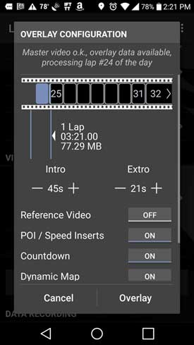

Harry, to further qualify this issue, when I attempt to export, I am getting the notification about "Number of laps avail for multi lap overlays reduced due to inconsistent sync points....". Then when I click ok, I get a screen with incomplete laps as shown in attached screen shot. The session starts with lap 23, which I cannot include with this dialog.
So I guess I am asking how to correct these sync points manually.
Also, why is this happening? Is it due to inaccurate GPS data? Would an external GPS bluetooth unit help? Or is it a bug within Android/LapTimer?
Doug

I should also add that if I play the raw video from Lap 23, the data is displayed until the end of lap 23, where the video goes on, but without data...

That means laps 23 and 24 are not considered to originate from one session. If e.g. a lap in-between has been deleted, you will get that situation. Two laps may well be covered by one video (like in your case), but have a gap in between. This is the reason for the message. The message is probably a bit misleading here because it addresses the second possible reason - that's when individual laps have been re-synced an do not fill the gap between the one before and the one after any more. While the former cannot be changed, you can resync all laps of a session as follows: select lap #24, select the Video section / Preview row and scroll to the bottom. Select the Lap #24 entry and adjust the sync point a bit (use arrow buttons, not scroller). Set the new sync and allow LapTimer adjust the full session (you will get a question). In case it doesn't include Lap #23, you need to overlay #23 and the rest separately.
