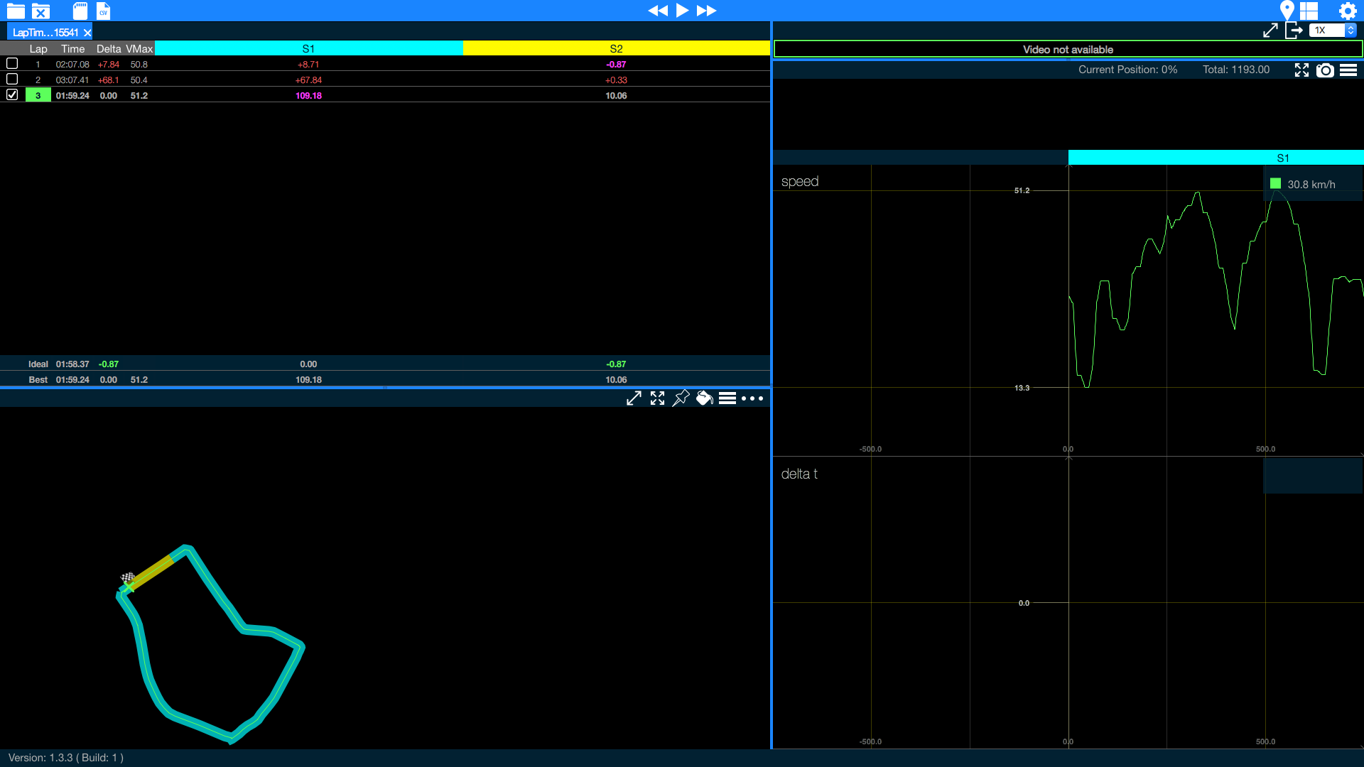

I have downloaded Racelogic Circuit Tools for MacOS and am having a couple of issues with it:
1. The software indicates "Video not available". I am using only the iPhone internal camera. The video is overlaid properly on HLT (3 lap session). I have exported the session data using the .vbo format. Do I need to do something else in order to export the video data to Circuit Tools?
2. The custom track works great in HLT, but when I export the data to Circuit Tools there are only 2 rather 3 sectors and the split is at a completely different place.
It would be great to have this working: I'd really like to be able to analyse the data whilst seeing my steering inputs at the relevant time.
Thanks a lot.

When exporting a VBO file from LapTimer, some instructions are included how to copy / rename the video so CT can find it. Data to lap analysis is done by CT independent from LapTimer's track set definitions. This means you will have different positions for start / stop and splits (as well as more or less of them).

Sorry, it is not in the mail, but in the VBO file (which is in the mail)... You will see something like this:
Code: Select all
[comments]
Generated by LapTimer v21.0.5
(c) 2006-2017 Harald Schlangmann
Rename or convert video LapTimerCapture-20131007-115440.mov to VID_0002.MP4

Thanks, Harry. I now have this working. It's such a useful feature. I thought it may be helpful to other new users to explain the steps (on a Mac):
1. Export the lap or session in .vbo format from HLT to the Mac.
2. Export the overlaid video from its location on the iPhone (e.g. Photos) to the Mac.
3. Open the .vbo file using TextEdit. The comments identify the file name which should used for the overlaid video file.
4. Rename the video file on the Mac.
5. Open the .vbo file using Circuit Tools.
6. Drag and drop the renamed .mp4 video file into Circuit Tools.
7. Close Circuit Tools.
8. Reopen the .vbo file using Circuit Tools. The video and data are synced.
