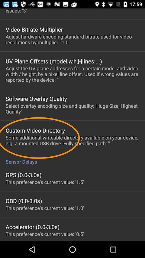

Instead of adding a special solution for a special device, you will find a new Expert Setting in LapTimer v21.0.5:
Once it is available, enter something like /sdcard/usbstorage/USB20FD. You will probably need to restart the app to get an effect.

Great, this looks like a very good solution.
Thank you!
