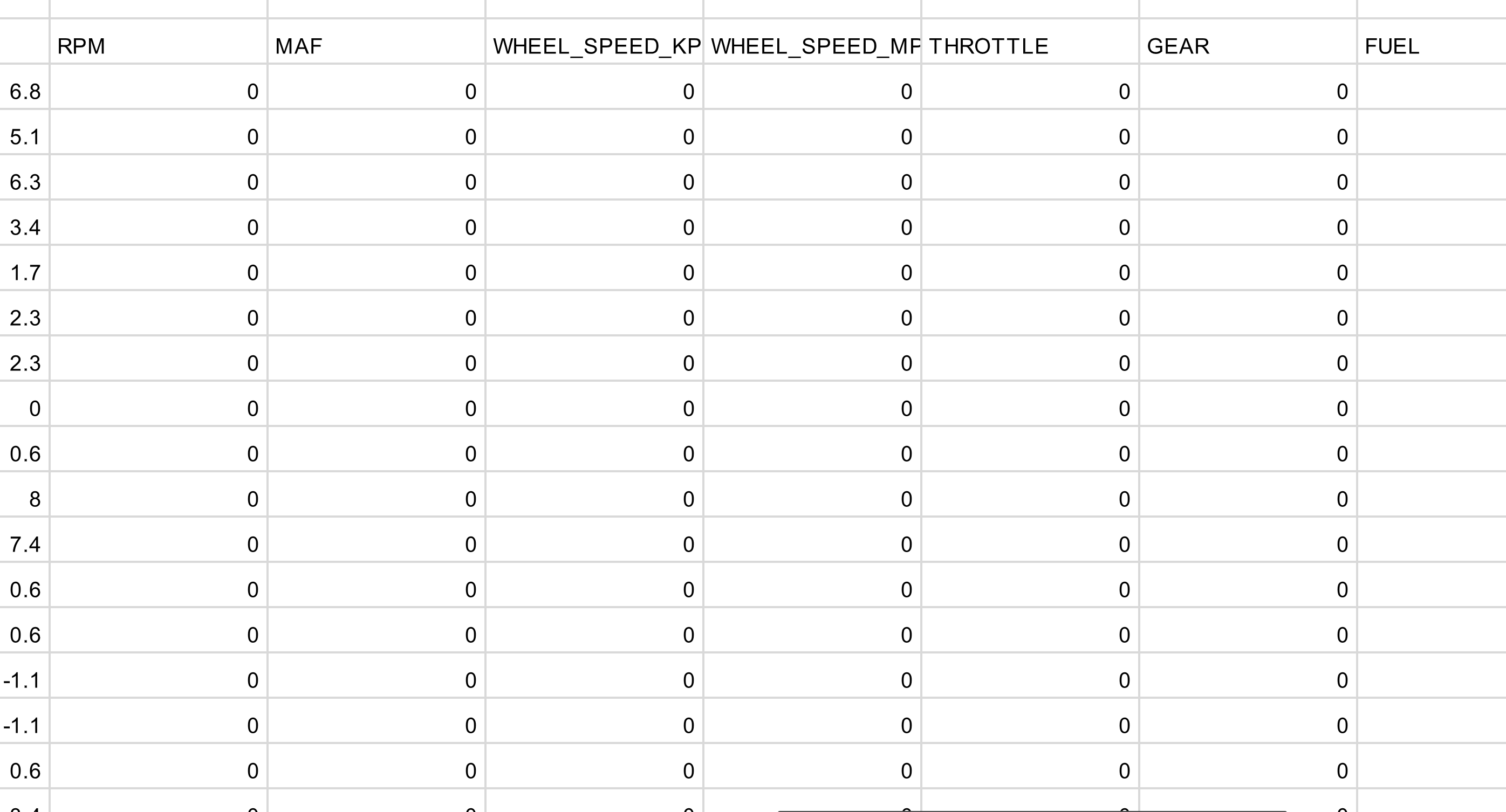

On the CSV file, many parameters and gauges gauges are indicating zeros the whole time. 2017 Dodge Challenger Hellcat. I want to log the relevant parameters including coolant temp I/C coolant temp and intake temp in addition to normal stuff.

You need a working OBD adapter to get these values. LapTimer pulls channels from GPS, accelerometer, and OBD if available.
See option on www.gps-laptimer.de/compatibility/ios or www.gps-laptimer.de/compatibility/android.
