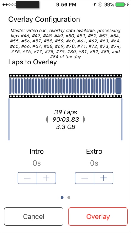

I have a 90 minute hot lapping session that I'm trying to export but whenever I go to export the video w/overlay, I keep getting my resulting video capped at about 36 minutes. This is despite selecting all laps within the session (and the GoPro + internal iPhone video also being 90 minutes long, verified by copying the raw video off the phone & SD card to a computer to view).
Has anyone seen this behavior? I'm using an iPhone 6S with tons of free storage as the rendering device. The video completes successfully, but is much shorter than expected. I also tried selecting another segment of laps within the session, and it too was shorter than expected.
I then swapped to just using the iPhone video, still produces a 36 minute movie.
Any ideas?

I'm experiencing a similar issue where only part of a session is successfully exporting, however, I have a different hypothesis as to what is occurring (as I don't think the issue is file or video size based):
I recorded 4 sessions this past Sunday. Session 1 exports all laps successfully; Sessions 2, 3 and 4 export the majority of each session, but NOT all laps in the session. Here are the number of laps in each session vs the number of laps successfully exporting:
Session 1 - 15 Laps Recorded (and all 15 chosen for export), 15 Laps Exported.
Session 2 - 18 Laps Recorded (and all 18 chosen for export), 15 Laps Exported.
Session 3 - 17 Laps Recorded (and all 17 chosen for export), 15 Laps Exported.
Session 4 - 19 Laps Recorded (and all 19 chosen for export), 15 Laps Exported.
Note the pattern/correlation: in all cases, only 15 laps are being included in the export regardless of the fact that all laps are chosen for export. This roughly correlates with the observation in the original post (e.g. 90 min/ 39 laps x 15 laps = approx 35 min).
*For reference, all laps recorded and exported using Grand Prix Edition v20.2.4 of HLT on iOS10.2.1 from an iPad Mini 4.
