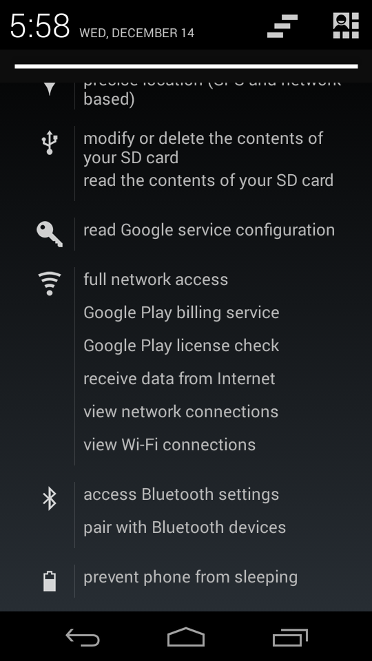

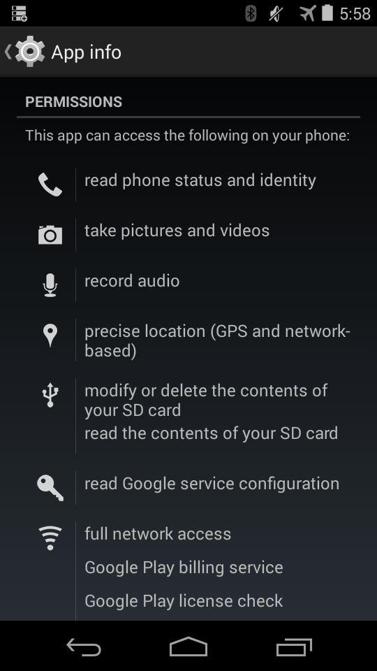

This phone is pretty old and running Android v4.4.2 and, from a quick google search, it seems enabling/disabling app permissions is only available on v6 and up. Here is the list of permissions:
EDIT: Checking the other thread it seems like he is running Android v4 as well. Maybe that is the issue?

Posted: Thu Dec 15, 2016 10:38 am
Yes, looks like an issue with older OS versions. I will fix this for the next release. As I am full on LapTimer v21 development already, this will probably take some time to get available. Not sure I can issue a separate v20 bugfix release here.
