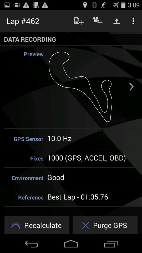

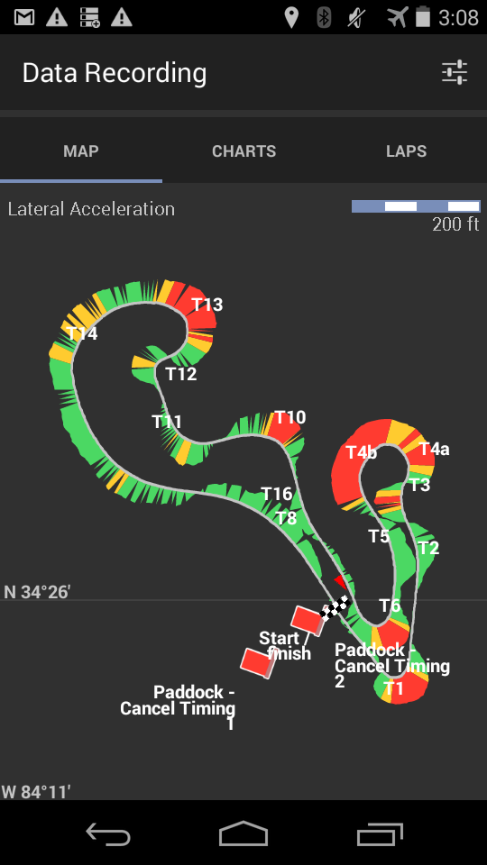

I've got a similar issue going on I think but I'm using the QStarz BT-Q818XT (10 Hz GPS) and the default 30Hz accelerometer update rate.
My Oct 22nd track day seems like the recordings earlier in the day looked fine but later in the day look choppy or have no colored accel. on the lap trace. The lat. accel. chart looks okay though.
Example #1
Example #2

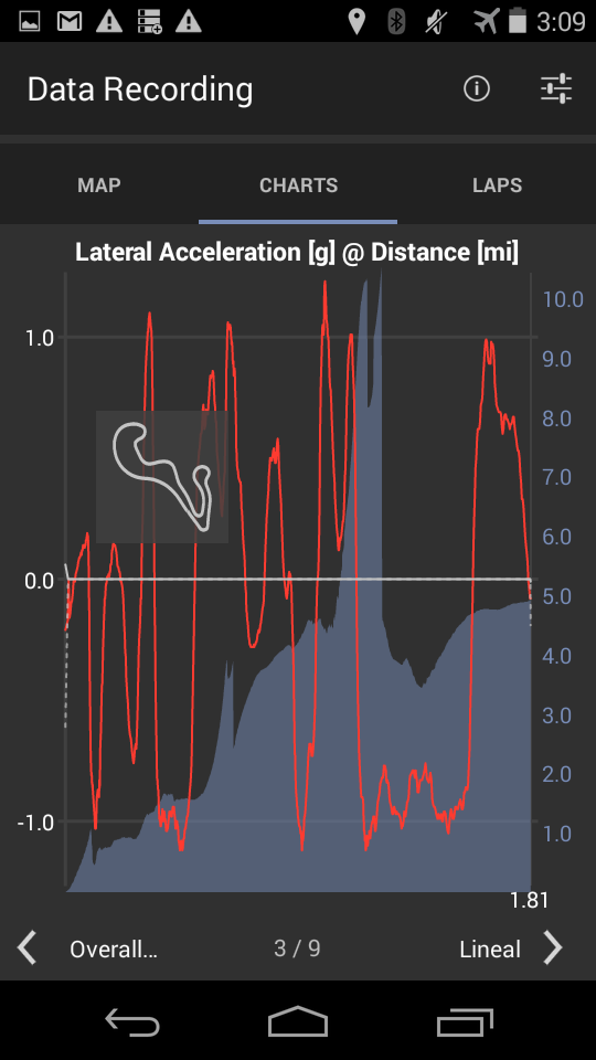

Then, my latest track day most of the lap traces look bare except of a few spikes. The lat. accel. charts are just noisy data. See below:

Please use Lap List ‣ lap with bad acceleration readings ‣ Recalculate ‣ Acceleration. This will allow you to replace measured acceleration by smooth calculated ones. I have no idea how the issue shown is created, but I will monitor if I see the patterns again. Using a 10 Hz GPS with 30 acceleration should be fine as (besides using internal sensors) it is the most common combo used.
