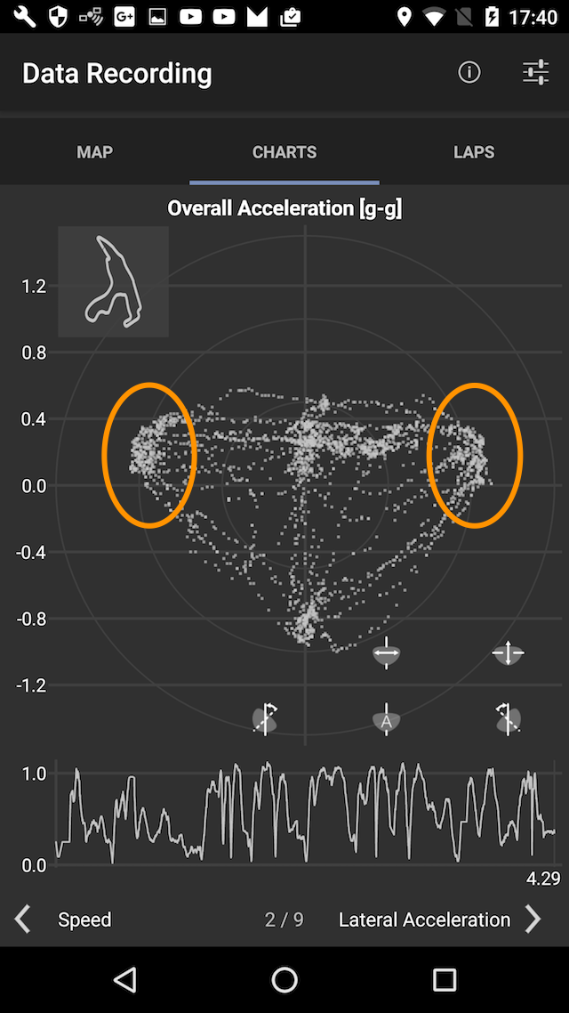

Accelerometers deliver quite noisy data. Ideally, LapTimer will smooth this data to an extent you get reasonable max values. The picture below shows the G distribution (both lateral and lineal) of a lap in Spa Francorchamps with 1.12 G max acceleration. The data has been recorded by a fast and consistent driver (not me). I have highlighted the areas of max acceleration. What can be seen is these areas show a high concentration / condensation (in German: Häufungspunkt) and will include the real max value. In case your data looks a lot less clustered with spots to the left and right - ignore them, they are noise.
Typical accelerometer precision for smartphones seems to be 0.01 to 0.02 G (see https://www.uni-weimar.de/kunst-und-ges ... ensors.pdf)

I'll check the friction circle data when I get home (out of town for a few days) to see if the high readings I'm seeing are likely to be outliers. I've been monitoring the data by slowly dragging my finger around chart of the track, and I can see the g's gradually building as I go around the fastest corners (all the corners, actually, lol), and the >1.2g values I see don't appear to be sudden spikes - they usually appear where I'm applying power at or just past the apex. Oh, and I'm using a Dual XGPS160, not a smartphone's built-in accelerometer. But I agree that it's hard to imagine that my car is actually capable of much more than 1.1g or so.

That's how smoothing using a rolling average works... 1 1 5 1 1 may result in 1 2 3 2 1. LapTimer has better algorithms for generating acceleration from GPS, but the measured acceleration will look more like the sample. You really need to identify the condensed areas.
