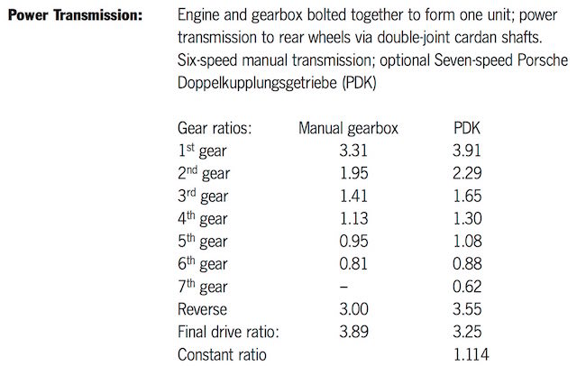

This is from the manual:
This means you need to enter 3.25*1.114 = 3.62 as the drive ratio.

I didn't understand the significance of the constant ratio. I don't even think I know what that means. Nevertheless, 3.62 is still too low to explain my on track experience.
I know PDK is shifting from fourth to fifth at around 121-122 mph I noticed it before I started using HLT and I can see it in the video. Assuming everything else is correct, and I do seem to agree with all the other published numbers, the number that will produce the correct gear numbers in HLT, which isn't necessarily the correct number, is 3.78. That's with 275/35/19 tires in the rear and a gear ratio of 1.30 for fourth.
One thing I don't know a way to put in is PDK seems to shift between 6900 and 7300 RPM in sports+, depending I think on whether I am ascending or descending and the side load on the car. Power peak is at 7400. My tac is white at 7400 and red at 7600 and I have assumed red line is 7500. I'm not sure how this factors into anything and maybe I am just over-analyzing.
Re: New user with two unrelated problems
Posted: Wed Aug 17, 2016 3:21 pm
Try it, it will work. There is no special magic for the Cayman. In case you find different values in your manual, change them. The constant ratio is some ratio added by the PDK.
