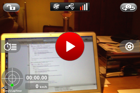

You are probably aware LapTimer has a setting named 'Manual Timing' that brings back the Go and Stop buttons from older versions. Today, these buttons are available in Classic View only - as it matches the association you have when looking to a stopwatch. Switching the named setting ON will not only add these buttons to all timer views again, but will exchange the small buttons in the top left of the Video View by large centered buttons too. Hope you will like it - in version 16.0 (don't ask for release dates please).
