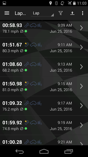

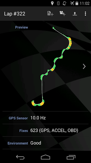

I was at Road Atlanta this weekend and about 50% of my laps had an incomplete recording. I noticed this after the first session so I deleted and reloaded the track set (not modified in any way) and restarted the phone/HLT with the same results in the following sessions. It was very frustrating.
90% of the incomplete laps cut off around Turn 7 but there was even one that happened as I was leaving the pits. There are no trigger points or even split markers near Turn 7.
The GPS signal looks good (QStarz with convertible top down). I have not had any issues like this with v19. I was at this track 2 previous times with HLT and have ~8 track days at other tracks with no issues.
See video, I am not stopping the recording manually in any way.
[youtube]https://www.youtube.com/watch?v=o9zJuBt9P8I[/youtube]
GPS Signal looks good
Incomplete laps (every other one in this image)

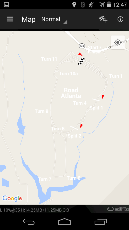

The detection engine is unchanged between v19 and v20. I assume this is some issue with the track set or a misplaced trigger. The later can sit in any track set on your device, not necessarily in the Road Atlanta group. Have a look into the Map View please, it will show all triggers and POIs . independent from track set. As an alternative, please send a .kml export of the complete session to Harry@gps-laptimer.de and I will have a look into it.

Harry, I emailed you the kml files. I have also included a screenshot of the "map" view. No triggers exist close to Turn 7.
Also, I can confirm there is an incomplete lap every other lap that is recorded. First lap recorded is complete, next is incomp., then comp., then incomp., etc.

Thanks for sending the .kml files. The incomplete laps show a end marker at the position they stop - which mean LapTimer has detected a trigger in this position. It seems to have been an stop trigger (used for auto crosses) and no stop/go trigger. This means LapTimer ran into the stop trigger and finished the lap. Then it idled until it found the regular stop/go trigger and started over with the next lap. As some laps are complete, the trigger has probably been some 100 meters away from the track - this depends on the corridor width used. The default is 40 meters to the left and right - but accuracy delivered by the GPS is added.

I really have no idea. The corridor width is set to 'Normal'. There are no triggers nearby besides the standard track splits and start/finish.
