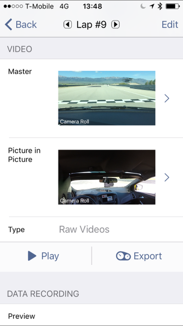

Here's the video view with the raw files:
Raw videos
Raw videos

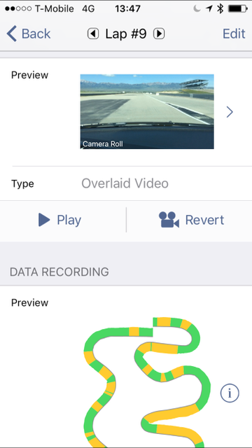

Here's the lap view with the overlaid files:
Overlaid video
Overlaid video

this doesn't look like the Export took place. In case an overlaid version is created, the two raw videos are removed from the display and you will get one video instead. Furthermore, the button showing "Export" will be hidden. Please press Export again. In the dialog appearing, do your settings and finally press "Overlay" in the bottom right. This will start the (lengthy) process of creating a new video from the two plus data.

Sorry, my mistake. I uploaded the same image twice. Here's a screenshot of the app after the export has taken place:
Sorry for the confusion!

Do you get the length overlaying process in-between? Actually you should see the result video in snapshot #2 if you go through the process... In addition, please goto photo app and check if you find an overlaid version of the video. In this case, there is some problem with the linking of Photo library and LapTimer.
