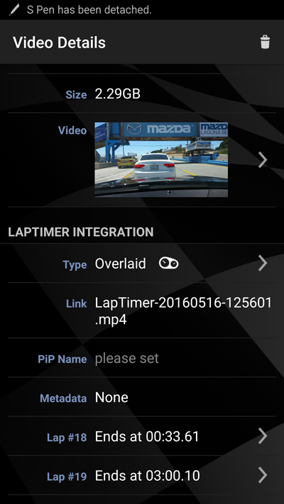

Please see the attached screenshot. There is no play or export.
Re: How to Overlay On Android
Yes, that's because you are in the Video Details dialog, not the Lap Details. ;-) Go back to Lap List, select one lap, and find the Play and Export buttons in the Video section.
PS You have switched the Video type from Raw to Overlaid in this Video Details dialog, switch back to Raw first.
