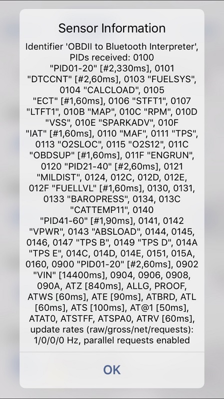

Finally got around to testing. I attached a screenshot of the info page. Not sure I see where the firmware number is displayed ... what am I doing wrong? :oops:
At any rate, HLT seems to be able to connect @7Hz initially. Sometime it would only connect @3-4Hz, other times not at all. I guess that would indicate it may have the older firmware?

Re: Best OBD adapter option for iOS + Bluetooth
I'm sorry, it is not listed here... There are probably other ways to check it, but the following works definitively:
Install the free app LightBlue from AppStore.
Start it and walk nearby the Kiwi plugged in.
You will see the Kiwi in the LightBlue app's list of "Peripherals Nearby".
Select it.
Once the dialog on the Kiwi is coming up, find the firmware version in the row name "Firmware Revision String".
