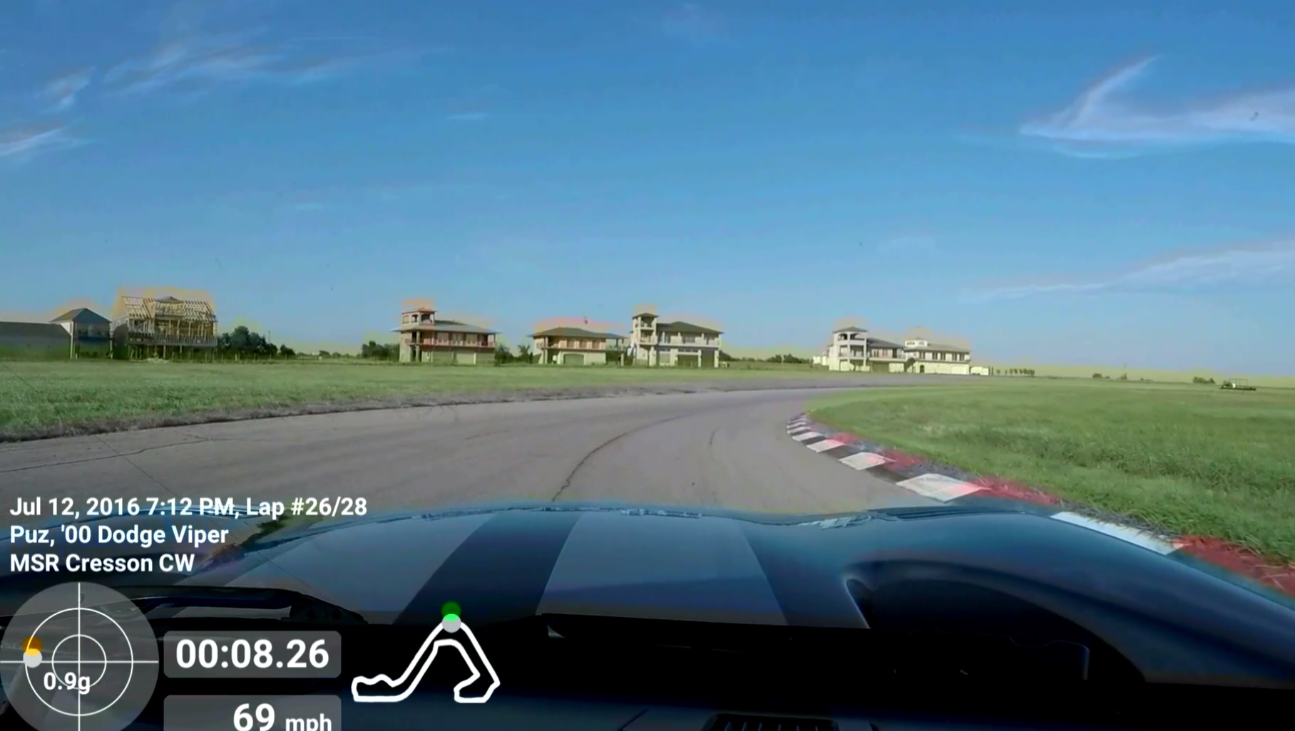

I am having the same issue with v20.0.15 on a Samsung Galaxy Note 4 (SM-N910T) running Android 5.1.1 and generating overlay on 1080p30 video recorded on GoPro 4. Switching to the software render generates the overlay correctly.
In the attached pic, you can see that all the colors are misaligned in the video, not just the overlay.
I had to crop the right side of the image to get below the 256k file size limit.
- overlay.jpg (242.08 KiB) Viewed 4543 times
Re: OverLay Color Mismatch
The device specific workaround implemented in LapTimer for the "SM-N910A" is not applied automatically to a "SM-N910T"... Provided the T model uses the same offsets (to be verified), I can change recognition to a SM-N910 prefix in a future release.
You can define you own workaround by setting the "UV Plane Offsets (model,w,h,[-]lines:...)" Expert Setting in LapTimer:
Try
to verify the T uses the same as the A and let me know if this fixes the issues.
NB: changing the pixel offset (+32 for HD and +16 for FullHD) to a wrong value may crash your phone when an overlay is generated.
Try
Code: Select all
SM-N910T,1280,720,+32:SM-N910T,1920,1080,+16NB: changing the pixel offset (+32 for HD and +16 for FullHD) to a wrong value may crash your phone when an overlay is generated.
That fixed it.
