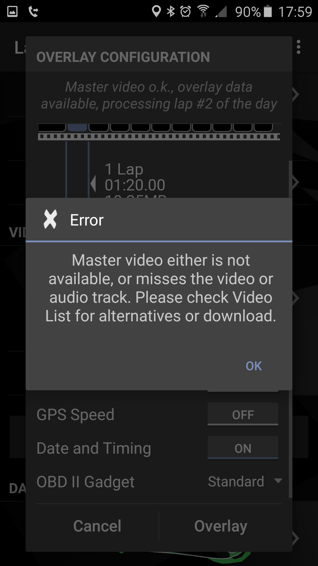

Now I can now longer render any thing...
"Master video either is not available, or misses the video or audio track..."
The preview works... (Still out of sync though.)

No idea on the Master missing - probably too much changed and some caching issue. Kill the app or reboot the phone and try again.
