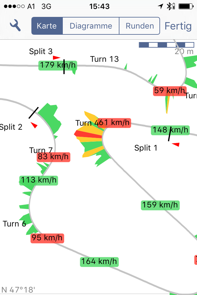

Attached the Screenshot of my iphone
May I ask you to comment the triangles, the Colors and th numbers?
(Maybe according a wrong Mount (landscape flat) the content is a mess, but in principle I´d like to know the meaning of
Ccolors and symbols.
Thanks for contribution.
Randy

When selecting Map (Karte), the default is to show the lap recorded with lateral acceleration as colored annotation. Green means below 0.95G, yellow between 0.95G and 1.15G and red above 1.15G. Thresholds can be adjusted in LapTimer ‣ Administration ‣ Settings ‣ Expert Settings ‣ Acceleration Colors (Android and iOS) and in the configuration dialog available using the small tool in the top left (iOS). They should be set specific for your motorbike in a way green means "too slow", yellow means "in the range expected" and red "too fast, take care".
Map has other options which can be switched to by pressing the small tool in the top left: longitudinal acceleration (to see brake and acceleration points), accuracy and lap by lap comparison.
The speeds shown are min and max speeds achieved. Min speeds are typically reached in corners, and max speed on straights. As an example the bottom most 164 km/h means you reached 164 km/h on this straight before you reduced the throttle / hit brake.
