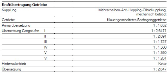

Can anyone tell me what gear ratio to use for a sport bike. BMW s1000rr 2016. I have all the gear ratios for 1-6
Ya I know rookie question

Gear ratios are listed here (2012 model):
For the drive ratio (which allies to all gears), you need to multiply the primary ratio and the ration from the chain: 1.652*2.647 = 4.373

Outstanding!
Thank You
