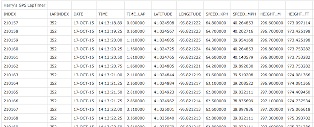

So, I exported a .hlptrl file from Android and imported the laps onto my iOS then exported the CSV data from iOS. Now it looks like the times are in GMT time zone so I take back what I said about it always being 12:XX:XX AM format. For some reason last time I exported from my Android it gave me everything in 12:XX:XX AM. I'll try exporting from my Android again and see if it still does the same thing again.
Anyway, after getting the time in GMT time zone it still displays as MM:SS.0 format. I have not done any processing. I'm not sure if it matters to excel what format is displayed to DashWare since I believe the time is really just a number in excel (divided by 86400). Again I have attached my iOS imported data, I have just trimmed the other laps out.

You were right Harry it looks like whenever I opened the exported CSV file to rename it and save it it automatically converts the time column to the MM:SS.0 format. I verified this by opening the exported CSV in Notepad in whicg everything looks good. Then opened the same file in excel, renamed and saved the file. Then opened the now renamed file in Excel and the time format was wrong. It seems like it is only an issue when the session changes hour.
What I was doing was exporting the entire day's lap data then opening that CSV and trimming the data into sessions by removing the rows of data from all other sessions. I now know I need to export each session individually and not open and save in Excel.
