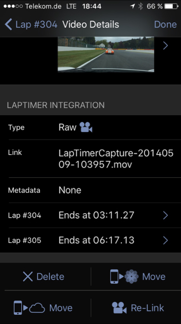

I have added a direct play of video sections for a specific lap to my feature request list. Here is how to work with the current version:
1) Select the video preview from any lap and scroll to zur bottom of Video Details:
2) Looking into the sample you see we have a session video with two laps associated. The first one starts at 0 and ends at 3:11.27. The second starts at 3:11.27 and ends at 6:17.13
3) In case you want to watch lap 2, start video playback and move the play position to 3:11.27
