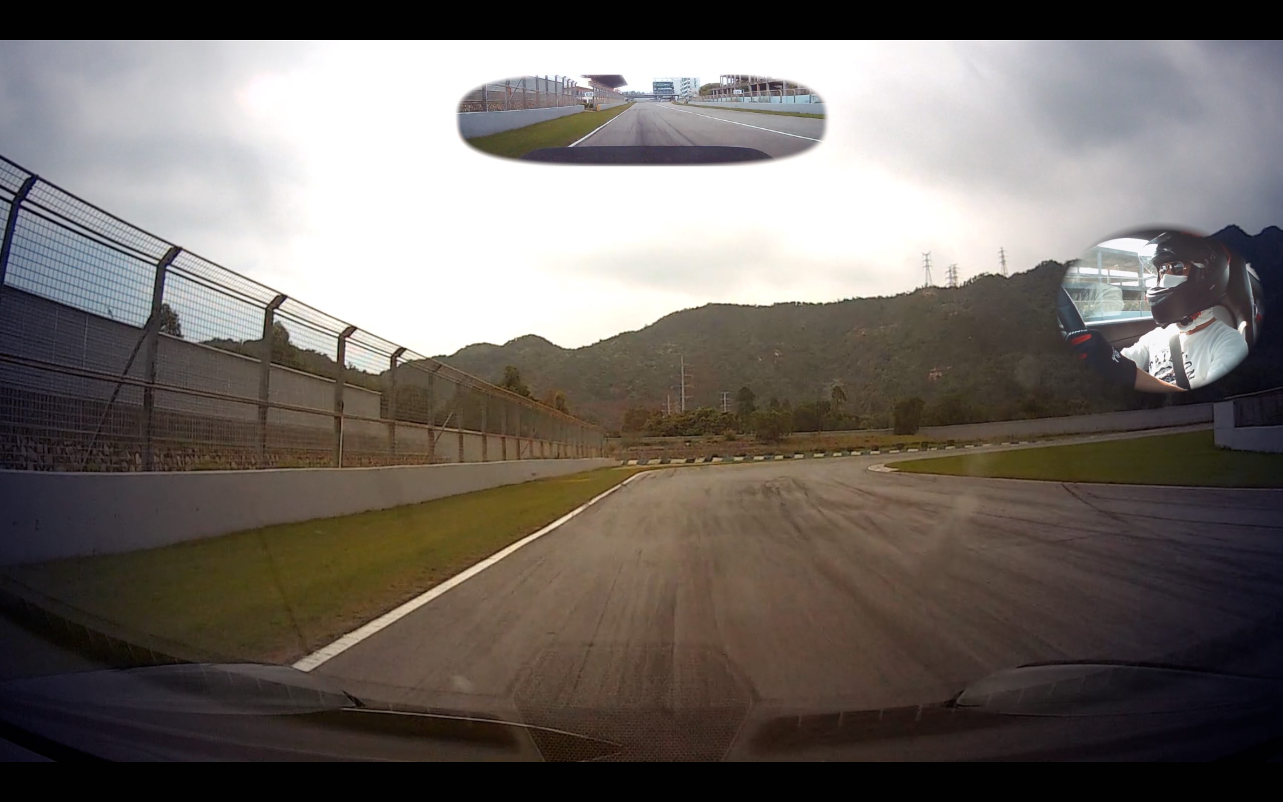

Attached are the 3 screen shots showing my workflow
1 - HLT graphic overlay on top of a blue video
1 - Blue Screen.jpg (242.34 KiB) Viewed 9113 times
2 - multi-cam editing on FCP: 1) main video 2) rear view window 3) driver
2 - Multi-cam.jpg (246.8 KiB) Viewed 9113 times
3 - HLT blue video clip is keyed on top of the multi-cam background using "Chroma Key"
3 - Composite.jpg (254.46 KiB) Viewed 9113 times

And this is an example of the FCP project, the HTL video is alway on the top layer
4 - FCP Project.jpg (254.05 KiB) Viewed 9112 times
