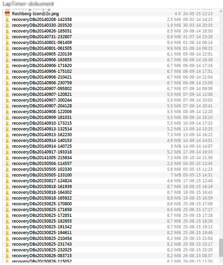

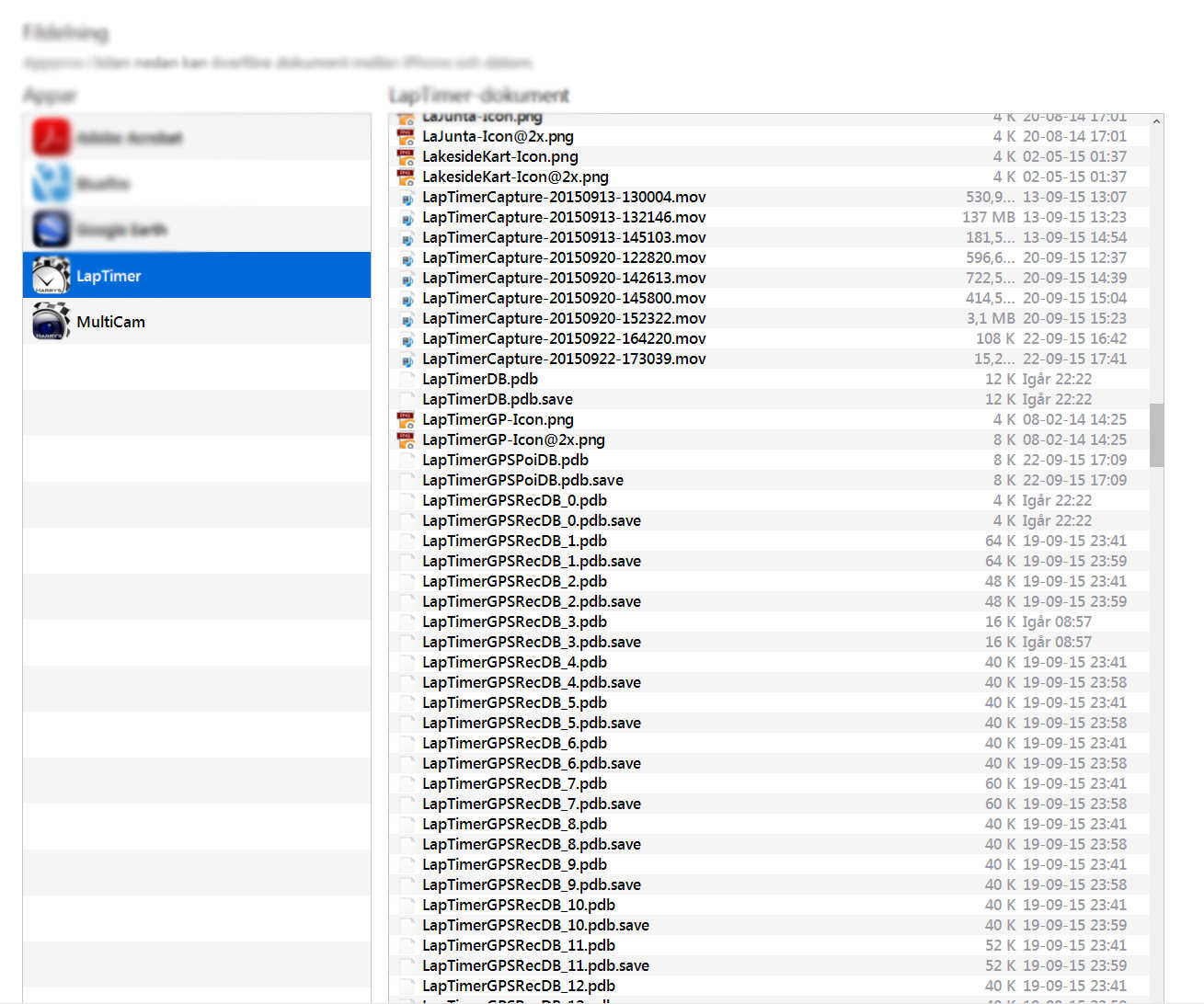

Anyway, these crashes have now caused a lot of recovery files taking up space on my iPhone... When I open the HLT app in my iTunes I see a lot of .pbd and .pbd.save files ("LapTimerGPSRecDB...").. And also a lot of folders named "recoveryDBs...." (see attached pictures)
Can these files and folders safely be deleted? How? Simply by clicking delete?

Please do not manipulate database files like this. There is actually an easier and safer way. But to start with, .pdb files are LapTimer's database and the .save versions are a backup to roll back after crashes. Deleting .pdb files will delete your data and deleted .save file will be recreated immediately when deleted. So hands off please :-)
The recovery folders however are automatic backups LapTimer created to not loss data. We probably need to check what the reason for this has been. For a quick check, you may send a Contact mail from within LapTimer and I will check the system log.
The easy and safe way to clean up is by entering Lap List, scroll to the bottom and press Check Data. This will check data consistency first and repair issues (if possible). Once this is done, it will check for a big amount of recovery dirs. In case there are a lot, it will ask if you want to delete all but the last three versions. In case the check worked without issues, you can usually confirm this deletion.
