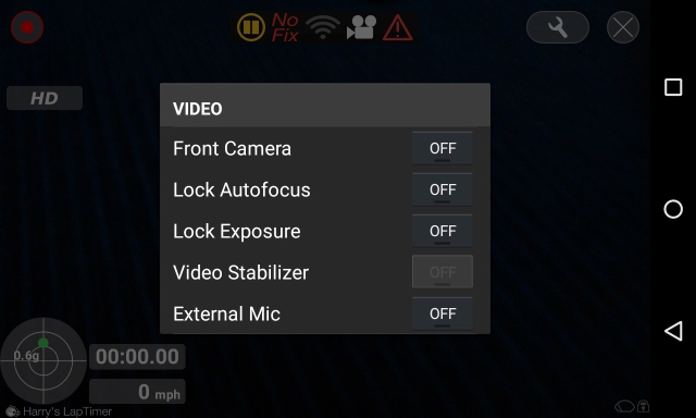

- ImageUploadedByTapatalk1440182026.729058.jpg (144.97 KiB) Viewed 2950 times
Press the small wrench in the top of Video View and you should see these options.

Don't you want to turn Lock Autofocus on? Off would seem to mean that autofocus is enabled, which you don't want.

The problem with locking autofocus is you need to point the device to the far distance at the time you lock it. It would indeed be better to have either continuous autofocus or focus to the far distance set... I will check for one of the next updates...

My screen looks just like the one you posted, with the video stabilization option greyed out. I have tried lock autofocus, but I am not sure that it was actually locked even though I selected it. I will try again using your suggestion of deliberately pointing it at the far distance, then select Lock Autofocus, then mount it in the car, and see if that helps.
