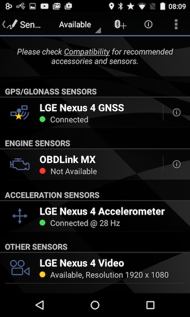

It should look similar like this:
Instructions are available here: viewtopic.php?f=39&t=2463

For the current device, if the sensor list looks like above, what happens when you plug in the adapter to your car and start the engine?

Please make sure the MX is listed in the Engine Sensor section. It should flip to Searching... from time to time. Please try the Insecure BT Connection Expert Setting next. Your phone probably requires this. There are several other things to check, but let's do it step by step.

Ok., I saw it listed under both Gos & engine sensors & deleted the one under GPS. I ticked the insecure BT setting but still no connection
