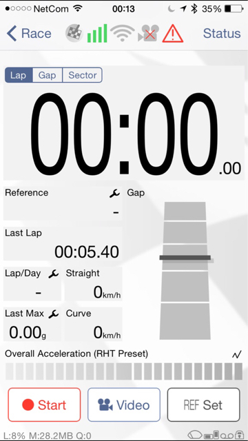

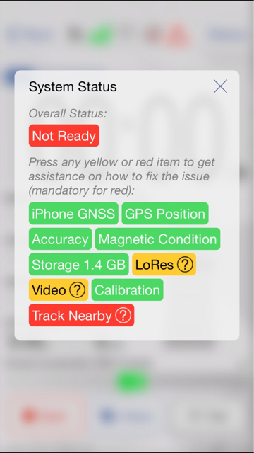

Re: re: Galaxy 6S GPS
Posted: Mon Jul 20, 2015 11:14 pm
I do not have an Android available right now, here are the corresponding views in iOS:
Posted: Mon Jul 20, 2015 11:15 pm
You get the first one when touching the red alert in the second.
