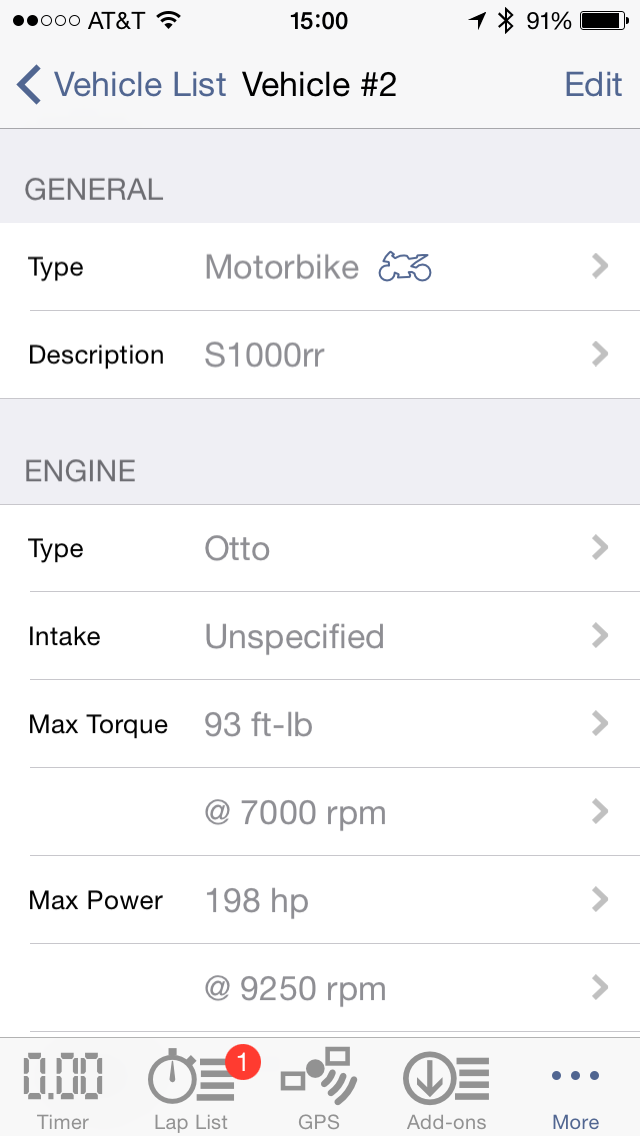

I think I did that already (set it up for my S1000rr) Would I get a motorcycle graphic if it were configured for a car?

Please check if it is selected as your current vehicle. In Timer View, press the small wrench in the top right and select your motorcycle. With the bike selected, you should see a lean angle video preview.

Thanks. It is and was specified and I did see the lean angle in the video preview while riding and shooting video.
